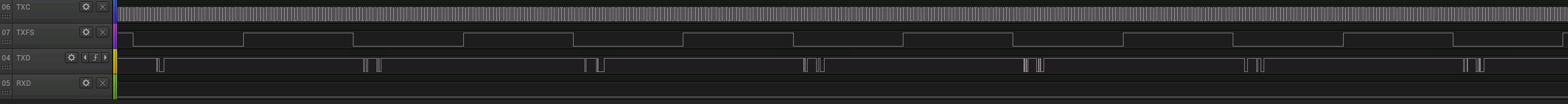

Hi @gustavo.tx ,
I managed to get some sound out of my module.
Therefore I added an extra line for MCLK from Colibri module.
Anyway it’s just mono. (also when using speaker test).
Do you have any idea why the output is just mono?

@p_nies,
Can you check the output with an utility such as alsamixer?
Also you may want to insert the routing and widgets entries to see all available outputs.
Is audio coming from just one of the channels (mono) or is the same audio coming from both channels (dual mono)? If it’s the former, which channel is the audio coming from?
@gustavo.tx
I’ve checked alsamixer / amixer already.
Headphone is unmuted (on both), PCM also.
When starting to play something with aplay or speaker-test I’ll also see an output (so all internal mixers are set correctly).
Anyway when checking the output with some kind of logic analyzer there is just data on one channel

@gustavo.tx
As you can see on the attached picture, there is only a signal when TXFS (Frame Sync) is on low, while there is no signal on TXFS high. This will cause the MONO Signal.
Anyway this signal is directly out of the Toradex Module. For my understanding the carrier board (also it could have a problem as well) could not emit any sound on one channel, because there is no data for this channel.
For testing i used aplay and “speaker-test -c 2” to get an output on both channel. The funny thing about it is.
One more thing:
When using arecord, i’ll get a signal on both fs (high and low) for recording
When using aplay/speaker-test, i’ll only get a signal on fs low but:
  • right channel: empty → signal data
  • left channel: signal → empty
It seems as if the signal for both channel will be put into one frame sync anyway it should be on both.

I’ve also attached an image of the logic analyzer again.
Now I’ve piped my arecord → aplay.
As you can see, the arecord is working as expected, the aplay not.
[upload|/nV7u2h+5N4+otKi+hJyexBagY8=]
For your information: I’ve also changed sai2 to master ( fsl,mode = “i2s-master”) but no efford.
Thanks for your help so far
