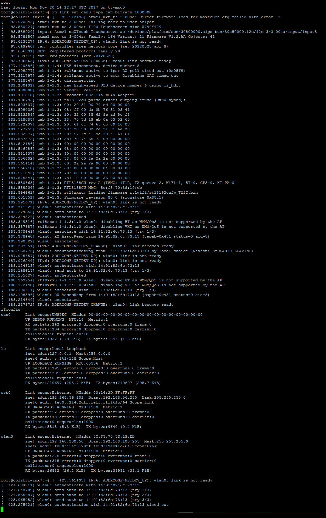

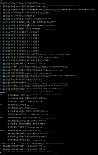

Often wlan comes “not ready” until I disconnect the wifi dongle and plug it in another usb port. Then it connects but after some minutes, wifi switches to the state “not ready”. After this point, no further authentification is possible until i reboot or use another usb port.
Do you have an idea how I will get wifi stable?
Screenshots are not really usefull, full dmesg output in text format is much better. You can try using usb hub between colibri and lm006, and moving to 802.11n network.
