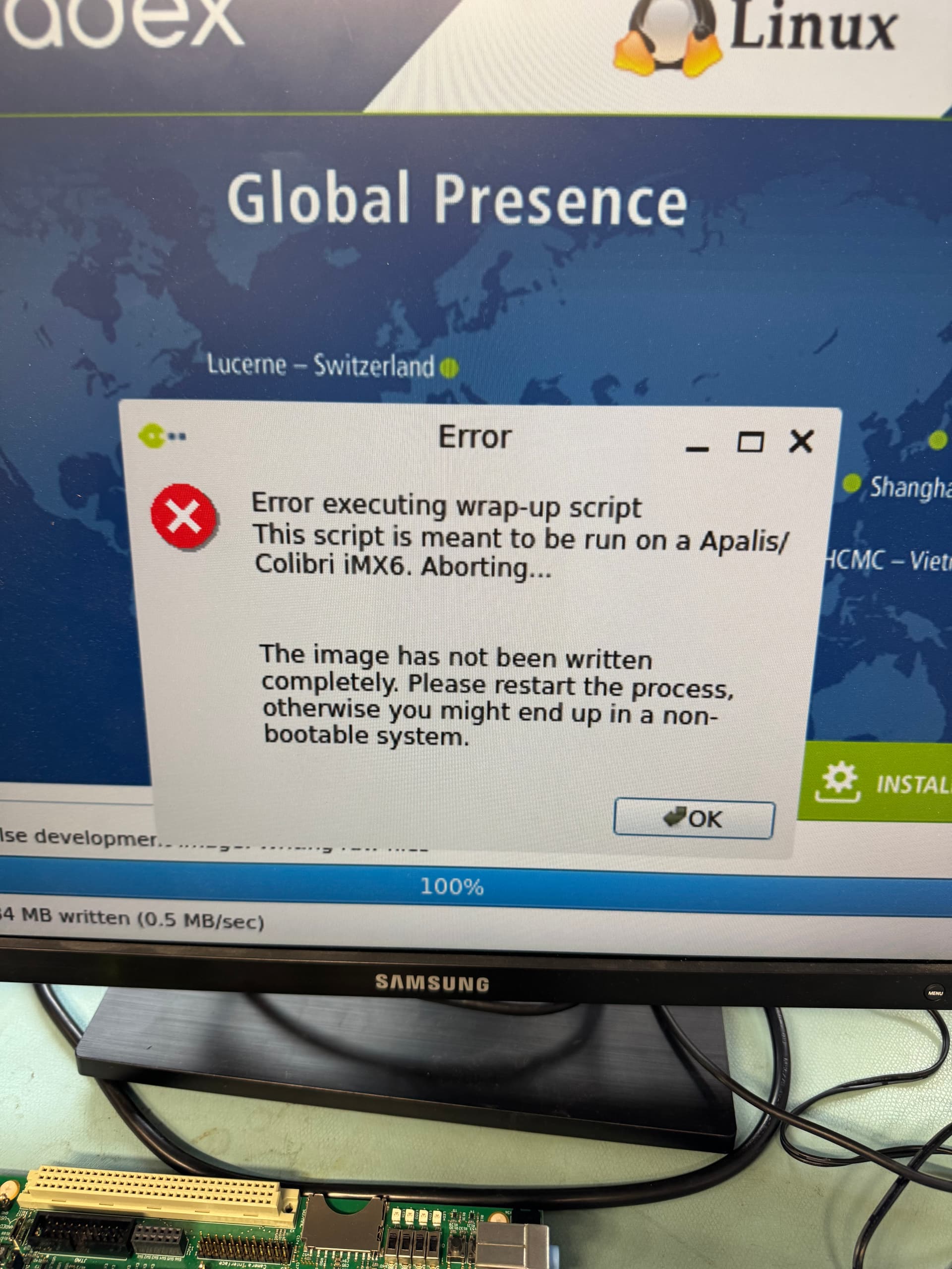

We are following the Flash a New Image Using Toradex Easy Installer instructions to flash one of our custom images, but it fails with the latest delivery of Colibri IMX6DL 1.1A modules. The error is:
Error executing wrap-up script
This script is meant to be run on a Apalis/Colibri iMX6. Aborting…
The image has not been written completely. Please restart the process, otherwise you might end up in a non-bootable system.

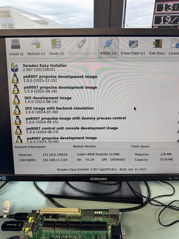

We repeated the same procedure with the same image but an older Colibri IMX6DL 1.1A module from our stock and it completed successfully.

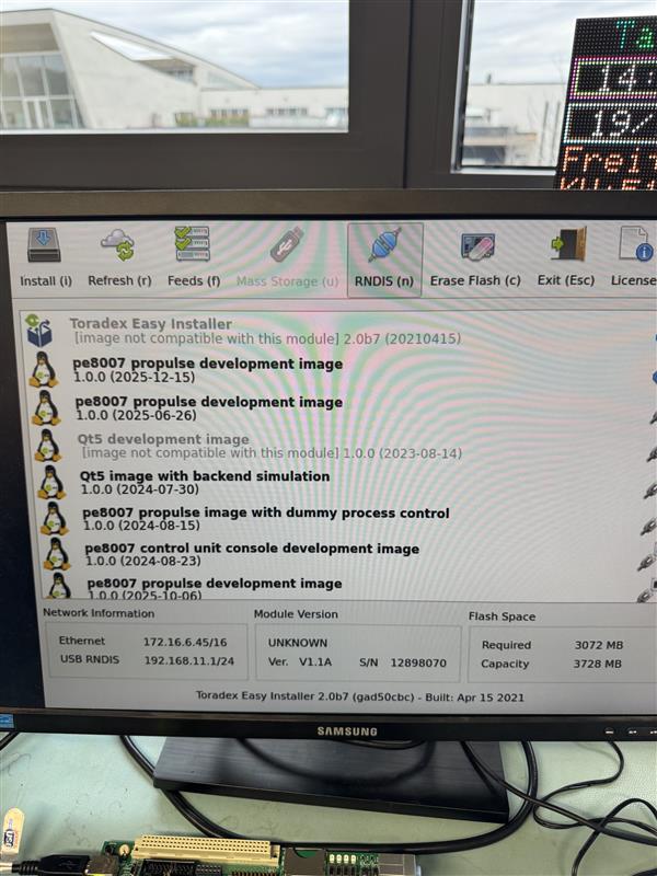

We noticed that the [EDIT: old new] modules are not recognized by the Toradex Easy Installer:
Module Version UNKNOWN
Here the same for the module from our stock:
Module Version Colibri iMX6 DualLite 512MB

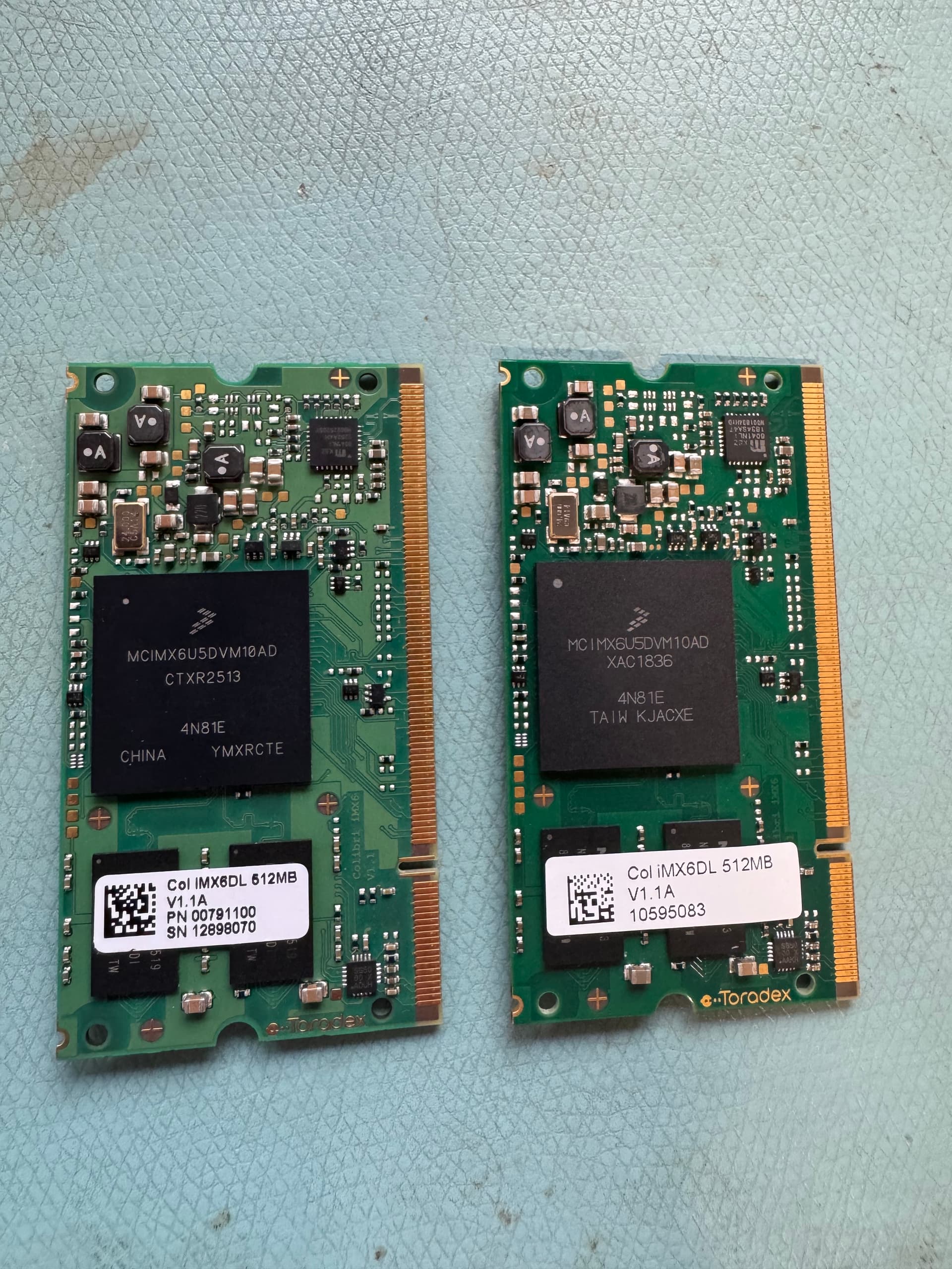

Here is photo of both modules. The failing module is on the left, the working module on the right:
Here are the differences in the labeling:
Failing module:
  • CTXR2513
  • CHINA YMXRCTE
  • PN 00791100
  • SN 12898070
Working module:
  • XAC1836
  • TAIW KJACXE
  • 10595083
Toradex Easy Installer Version is 2.0b7 (20210415).

case $PRODUCT_ID in
0027|0028|0029|0035|0082|0083|0084|0085) ;;
0014|0015|0016|0017|0077|0078|0079|0080) ;;
*) error_exit "This script is meant to be run on a Apalis/Colibri iMX6. Aborting...";
esac
Why Both Updates Are Required
  1. Top-level image.json: Controls whether the Easy Installer recognizes and displays your custom image as compatible with the new modules
  2. Custom image wrapup.sh: Prevents the “This script is meant to be run on a Apalis/Colibri iMX6. Aborting…” error during the actual installation process(1)
Without updating both files, you’ll encounter the exact error sequence you originally described - the image might appear installable, but the installation will fail during the wrap-up phase.
This complete solution ensures compatibility with both legacy modules (0014-0017) and new modules without Windows EC licenses (0077-0080)(1).
