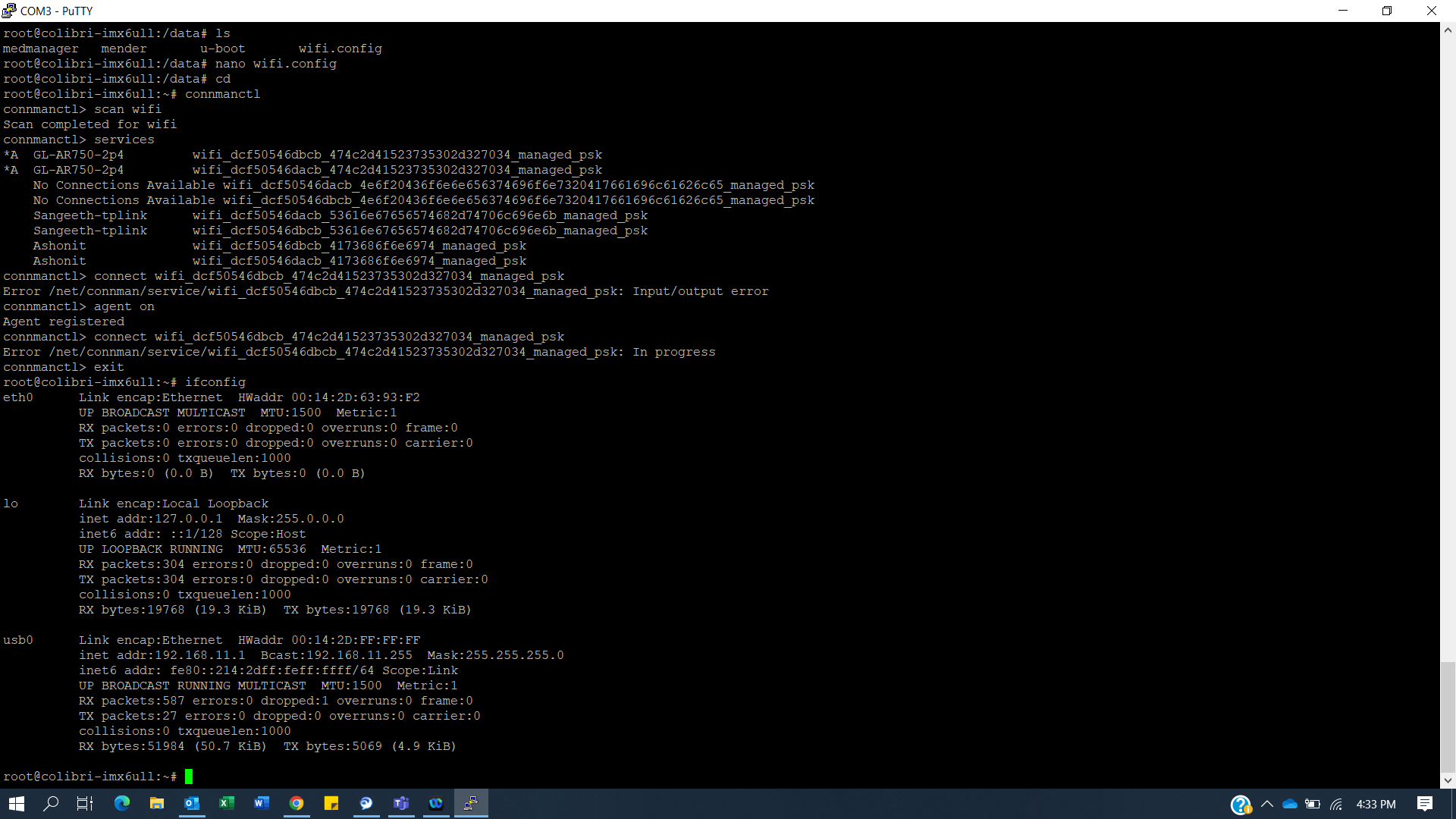

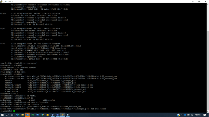

Hi
I am using collibri development board and using module imx6ull 512 mb
while connecting to the network its not connecting

Hi @ayyappan_s ,
You missed to register agent. Use the following
connmanctl> agent on
Agent registered

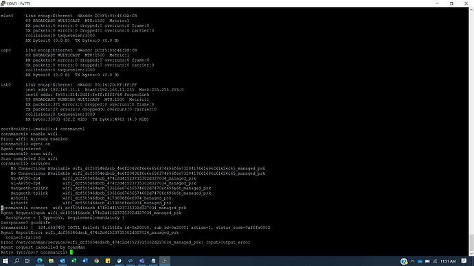

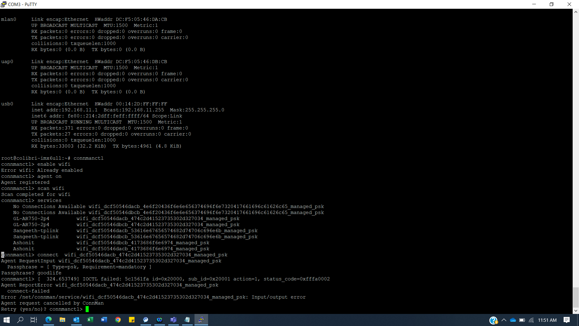

hi @ayyappan_s ,
Please follow the steps as given below
root@colibri-imx6ull-06398948:~# connmanctl
connmanctl> enable wifi
Error wifi: Already enabled
Agent registered
connmanctl> scan wifi
Scan completed for wifi
connmanctl> services
Toradex_5GHz wifi_d0c5d333ce8b_546f72616465785f3547487a_managed_psk
Toradex_5GHz wifi_d0c5d333cc8b_546f72616465785f3547487a_managed_psk
Toradex_2GHz wifi_d0c5d333ce8b_546f72616465785f3247487a_managed_psk
Toradex_2GHz wifi_d0c5d333cc8b_546f72616465785f3247487a_managed_psk
connmanctl> connect wifi_d0c5d333ce8b_546f72616465785f3547487a_managed_psk
Agent RequestInput wifi_d0c5d333ce8b_546f72616465785f3547487a_managed_psk
Passphrase = [ Type=psk, Requirement=mandatory ]
Passphrase? ToradexDelhi
connmanctl> [ 1665.064035] mwifiex_sdio mmc1:0001:1: info: trying to associate to ‘Toradex_5GHz’ bssid 04:25:e0:dd:86:8d
[ 1665.088625] mwifiex_sdio mmc1:0001:1: info: associated to bssid 04:25:e0:dd:86:8d successfully
[ 1665.208482] IPv6: ADDRCONF(NETDEV_CHANGE): mlan0: link becomes ready
Connected wifi_d0c5d333ce8b_546f72616465785f3547487a_managed_psk
connmanctl>
Hi @ayyappan_s ,
I am not able to reproduce the issue at my end, its always connecting for me.
Consider these debug points.
