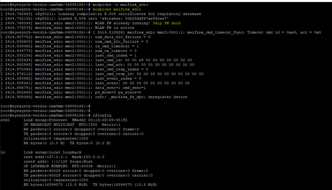

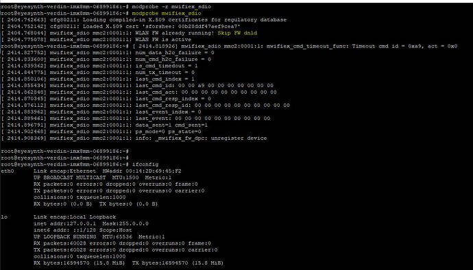

Sometimes the SoM WiFi adapter/interface does not appear after powering on. This doesn’t always happen, but when it does I can’t reboot the AW-CM276NF module. If I turn off the SOM and turn it back on, the error disappears.
When the WiFi interface (mlan0) disappears, I have tried removing the driver and reloading it but this does not solve the problem. Apparently the driver when booting does not force the reset of the AW-CM276NF module and checks if the module has its firmware loaded. Since the module already has the driver firmware loaded, it does not load it again and the WiFi interface does not appear. Below I show the console output when performing this test.
NOTE: During these tests the system never goes to sleep.

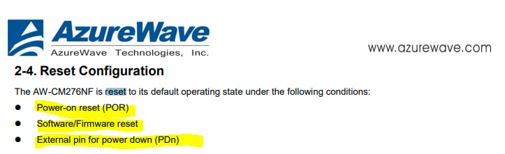

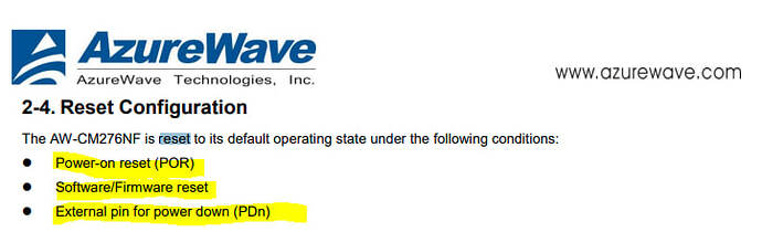

According to the data sheets of the AW-CM276NF module there are 3 sources to reset the device. Do you have implemented the reset through sw/fw or gpio?
