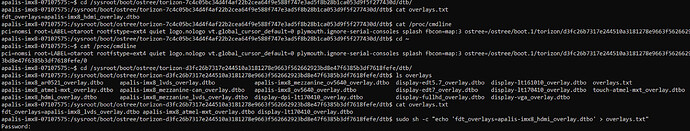

you can see here that he initially changed the overlays in the following folder :
apalis-imx8-07107575:~$ ls /sysroot/boot/ostree/torizon-7c4c05bc34d4f4af22b2cea64f9e588f747e3ad5f8b28b1ca053d9f5f277430d/dtb/overlays
in the screenshot he then followed the right steps and changed the hash code to the proper one d3fc26b*****************
The question here is how is it possible to have the same folders with different hash codes, it seems like something that could lead to unintended errors
I am not entirely sure if he used the same ixora board I used while doing my list of steps or another one, probably the same one but after updating the firmware from the PREEMPT_RT version to the normal one
sorry if the explanation is confusing, please let me know if this hash codes are unique for each device or not

Thanks for reaching out. TorizonCore images use libostree to handle file system updates ( OSTree | Toradex Developer Center). Every time you upload a new image to your board either through the platform or via the deploy command on TorizonCore Builder, the following may usually happen:
- If there was only one update sent, the OSTree would create a second
torizon-checksum folder. This way, if there was a problem with the custom image, the library would do a rollback and return to the previous File System.
- If there were two of these folders already, it would delete the older one and then create a new one following the same idea as above.
It is possible to change the default Ostree behaviour and retain more than 2 deployments as explained in the article.
This is why you have two “identical folders” with different hashes. As you updated from the PREEMPT_RT to the normal one, it explains this behaviour. Every deployment will have its checksum.
If you run
ostree admin status
you’ll have all the available deployments and the one tagged with an * will be the active one.
You can get the correct checksum also by running this command:
awk -F "ostree=" '{print $2}' /proc/cmdline | awk '{print $1}' | awk -F "/" '{print $5}'
Does this explain the topic to you?
