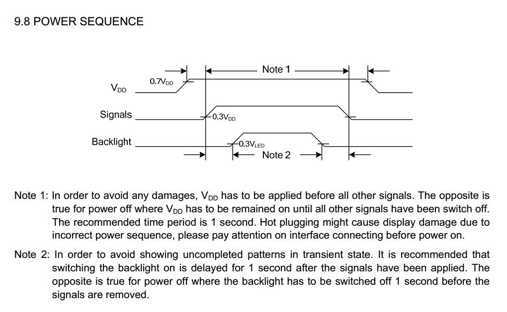

The Enable Display power signal needs to go on and off at different times then the backlight enable signal. Most LCD want something like the attached picture.

As such there is no standard way of handling the external display power sequence control in Linux/U-Boot. One can add the power sequence in U-Boot have a look at this for information on accessing GPIOs in U-Boot.
