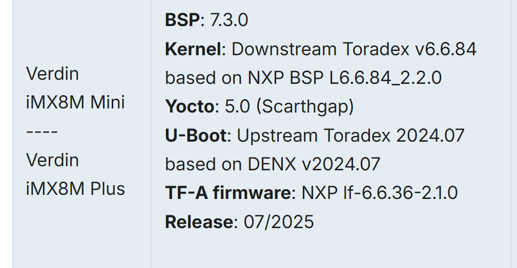

Based on the Embedded Linux Release Matrix, I can see that BSP 7.3.0 is not yet documented in the available sources (2). The matrix shows releases up to BSP 7.2.0 for the Verdin iMX8M Plus, which uses “Downstream Toradex v6.6.84 based on NXP BSP L6.6.84_2.2.0” (2).

2. Upgrading from BSP 6.8.2 to 7.3.0
Since you’re currently using BSP 6.8.2, you would need to update your build system to use the newer BSP version. However, the documentation available shows releases up to BSP 7.2.0 (2).

The kernel version “6.6.94-6.8.2” you’re seeing indicates you’re using BSP 6.8.2 (2). To get the most current stable release, you should check the Embedded Linux Release Matrix for the exact tags and branches corresponding to the BSP version you want to use.
For the most accurate and up-to-date information about BSP 7.3.0 availability and specific kernel tags, I recommend checking the current Embedded Linux Release Matrix, as the available documentation shows releases through BSP 7.2.0.
