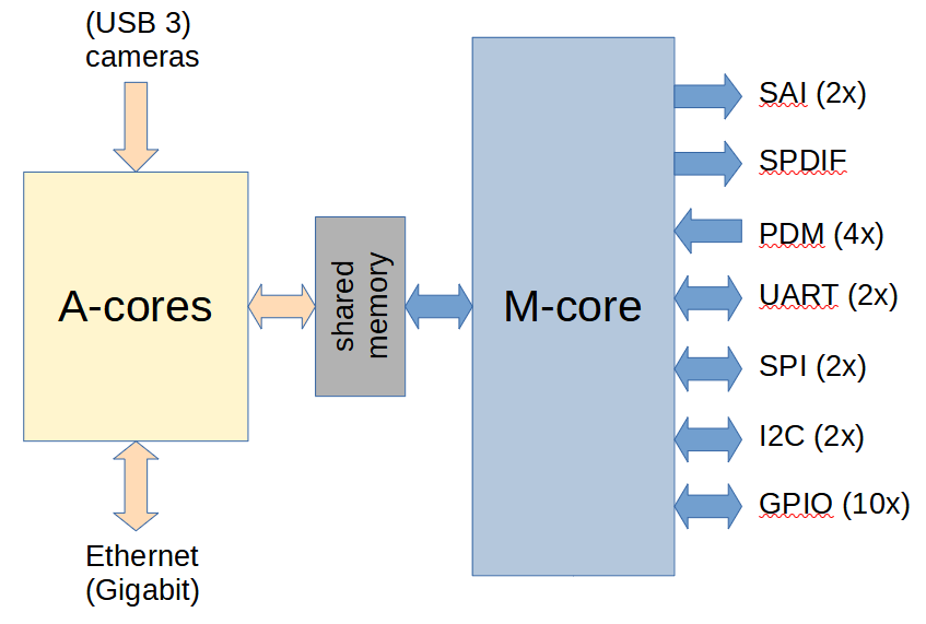

We want to develop a 3D audio sound system for a simulator cabin. A block diagram would look like this:
We will add a custom board that uses all the different peripherals on the M-core side.
The question is how does the software development workflow would look like for this setup?

Hi @simmania !
Welcome to the Toradex Community! :tada:
Thanks for sharing a bit about your project. It makes it easier to understand where you are getting into :smile:
I will first try to go through your “direct” questions:
Yes. On TorizonCore (the Linux Distro developed by Toradex for our modules that is part of the Torizon Ecosystem) your application is meant to run inside a container.
These references are interesting here (maybe you found these links already):
I can’t say no here. If you manage to put VS Code in a container, you will have it running in your module.
What I can tell you is that this is not recommended! Like any embedded systems development, you should have the development tooling in a computer (your workstation), develop on it and deploy/test also with remote debugging on the target.
The Torizon IDE extension for VS Code is meant for that. The following links are good references:
If the cameras you need to use have already drivers available in the Linux Kernel version we use on TorizonCore, and we have them enabled on the image, it should just work. You can check that yourself by following what we have here in the introduction section of the Building External Kernel Modules With Torizon | Toradex Developer Center article
Exactly :+1:
Both are possible because of MCUXpresso :wink:
Just to be clear here, you won’t use MCUXpresso to connect JTAG or USB. JTAG connection you are going to use during debug with gdb.
Here is where I need to summon @hfranco.tx , who can help us a lot on Cortex-M topic :slight_smile:
@hfranco.tx , if you have more information on @simmania’s previous question, please share :slight_smile:
Now, going into your more open question:
For applications running on TorizonCore, you can use the Torizon IDE extension (shared above), which allows you to start from some of the templates that we have for some programming languages. The extension accelerates your development as it containerizes your application, deploys to the target, and also has remote debugging for the templates available. For Cortex-M, you will use MCUXpresso, as you guessed already, and @hfranco.tx can give you more details if you need them.
