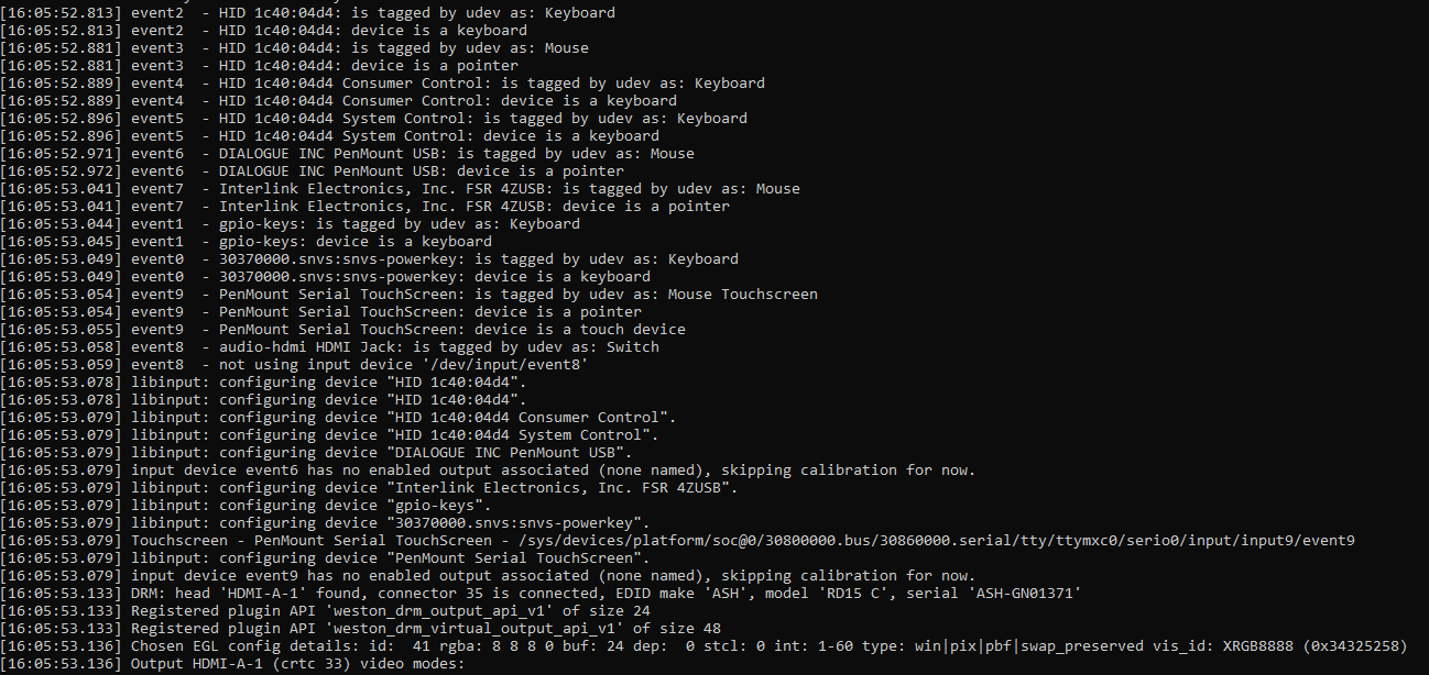

I have tried to test the touch with the “evtest” tools. And the touch isnt active on the input identified as my touchscreen from the weston-touch calibrator container. However it is active on another input identified as Mouse from the container.
The event9 is identified as my touchscreen but the touch isn’t active but it’s active on the event6.
I have already tried to change the event6 into a touchscreen and the event9 into mouse or something else but it is not working.

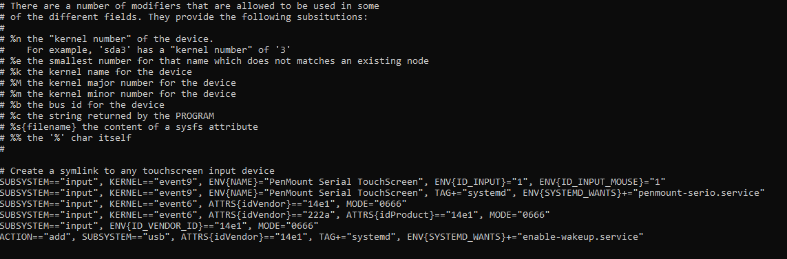

I have change the touchscreen.rules files :
My touchscreen isn’t Linux native so I have tried to manually change some settings to make it functional.
So you’re trying to use a udev rule to get your mouse interface to come across as a touch interface? Can’t say I’ve tried this and not sure if it will work quite right. Though for reference here’s what the udev of a touchscreen would look like: Touch Screen Calibration (Torizon) | Toradex Developer Center
