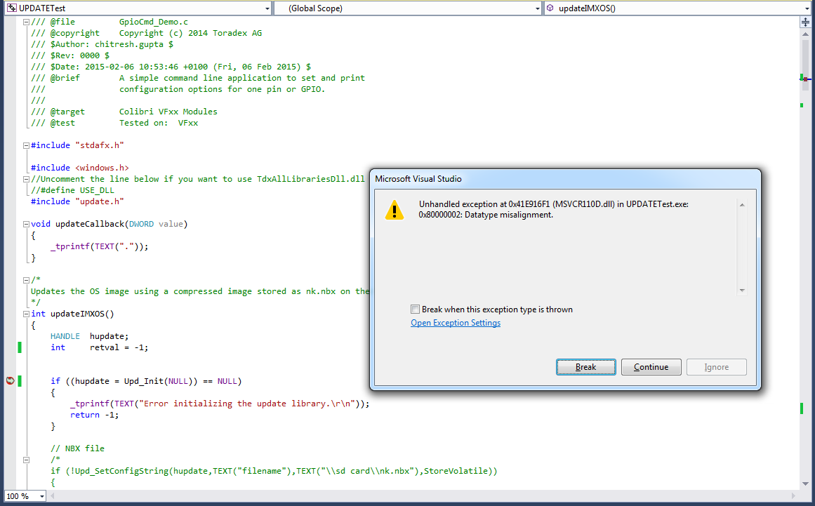

The Toradex demo program has the following error message:
What can I change to make it work?
Thanks in advance.

The solution is not in the actual libraries, but in the project file of your application:
The following sections of UpdateLib_Demo.vcxproj have been updated to fix the problem. Particular functions (such as for memory allocation) are available in different flavours in Visual Studio’s standard C library ( libcmt.lib) as well as in the OS. The changes below force the linker to use the OS version of these functions.

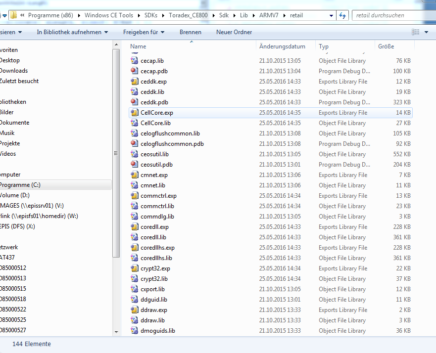

1>LINK : fatal error LNK1181: cannot open input file ‘corelibc.lib’
Where can I find this Lib?
Dear @troubadix
The corelibc.lib is part of the SDK, typically located at
C:\Program Files (x86)\Windows CE Tools\SDKs\Toradex_CE800\Sdk\lib\ARMV7\retail\
This path should be searched automatically if your Toradex_CE800 SDK is properly installed.
Regards, Andy
i think the SDK is installed properly - but in this path there is no corelibc.lib.
@troubadix,
msvcrt.lib is same as corelibc.lib. So, could you please
 Copy C:\Program Files (x86)\Windows CE Tools\Toradex_CE8_SDK\Sdk\Lib\ARMV7\retail\msvcrt.lib
   to   C:\Program Files (x86)\Windows CE Tools\Toradex_CE8_SDK\Sdk\Lib\ARMV7\retail\corelibc.lib
and use it.
