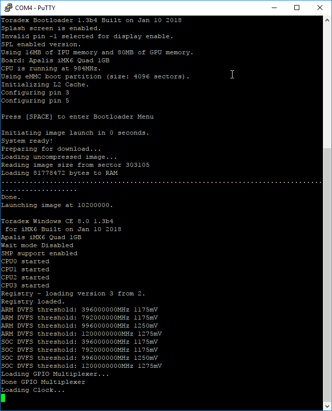

sometimes our OS hangs during boot, but I can’t reproduce it reliably.
The last output is always “Loading clock…”

Now it stops here:

Loading 2D/3D Graphic Accelerator...
GALCORE 4.6.9(9754) (Sep 19 2014 12:04:16)
Sorry, that is the GPU driver.
You can disable it too by setting:
[HKEY_LOCAL_MACHINE\Drivers\BuiltIn\GCHAL\] <br/>
"Dll"="_libGALCore.dll"
Seems to be a workaround. When we change both registry keys the OS boots successful.
[HKEY_LOCAL_MACHINE\Drivers\BuiltIn\Clock]
"Enable2D3D"=dword:0
[HKEY_LOCAL_MACHINE\Drivers\BuiltIn\GCHAL]
