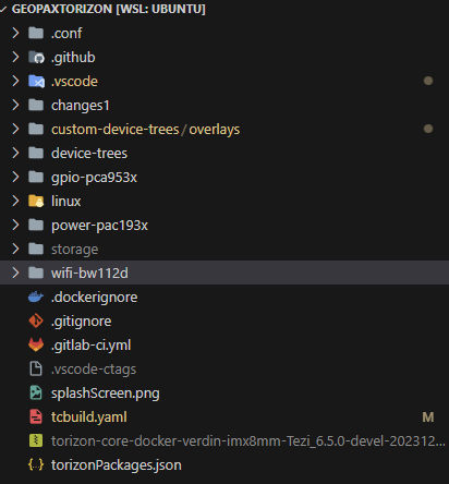

Could you provide any insight on this? I apologize for directly tagging you. I have seen the youtube video but I can not seem to get it working. I am attaching the folder structure and workspace settings in case you require it for an answer.

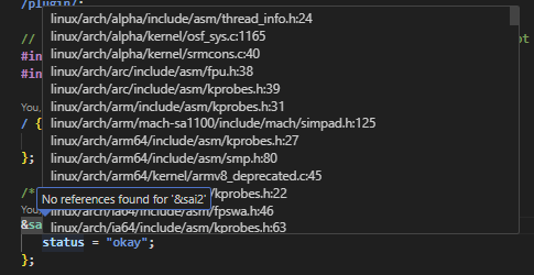

Thank you! it starts working and gives suggestions along with reformatting etc.
But the suggestions are weird.
for example, with the following lines in the overlay, the provided suggestions are generic, that is, based on anything that contains similar keywords in all of the main directory. not essentially related to the verdin-imx8mm. I belive there is an issue with the project structure and the devicetree.bindings setting:

Seems to me that the ctags are still working in the device tree. Try to remove the .vscode-ctags file in the root of your project, close and open the VS Code again.
Let me know.
