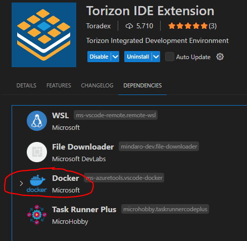

I’ve just updated the IDE extension to v3.0.109 and I see in the changelog
[NEXT]
* Add network device filter;
* Use the new Microsoft Container Extension;
But in the Dependencies I see that it depends on Docker (and not Microsoft Container)

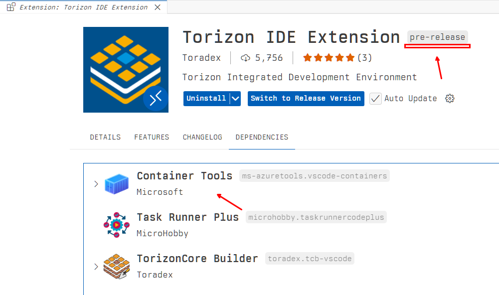

Hey @vix
Could you send a screenshot and logs?
On our side, it seems correct, at least if you install the pre-release version.

What I posted refers to the IDE extenson in Windows (that is supposed to setup a working WSL).
I cannot install a pre-release in Windows.
I suppose that your screenshot and logs comes from WSL.
I’ll do test in WSL in the next few days.
ok, got it.
Yeah, at end this dependency for Windows side does not make sense. We will remove it.
