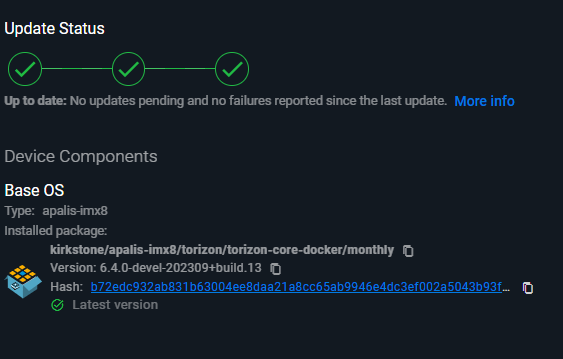

Hi there @jeremias.tx ,
6.4.0-devel-202309+build.13
