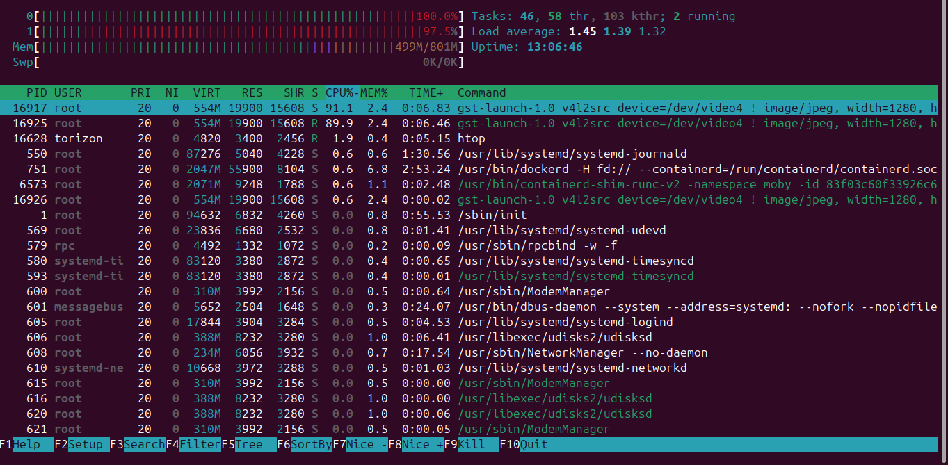

Here’s the output from htop during execution:

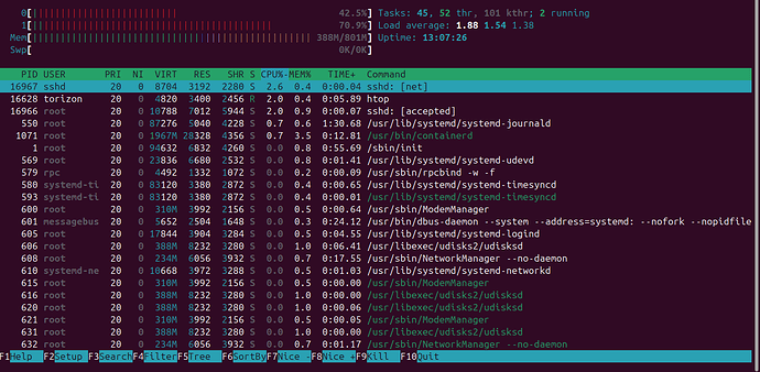

And here’s the output before execution:
The result is a poor video around 16 fps.
