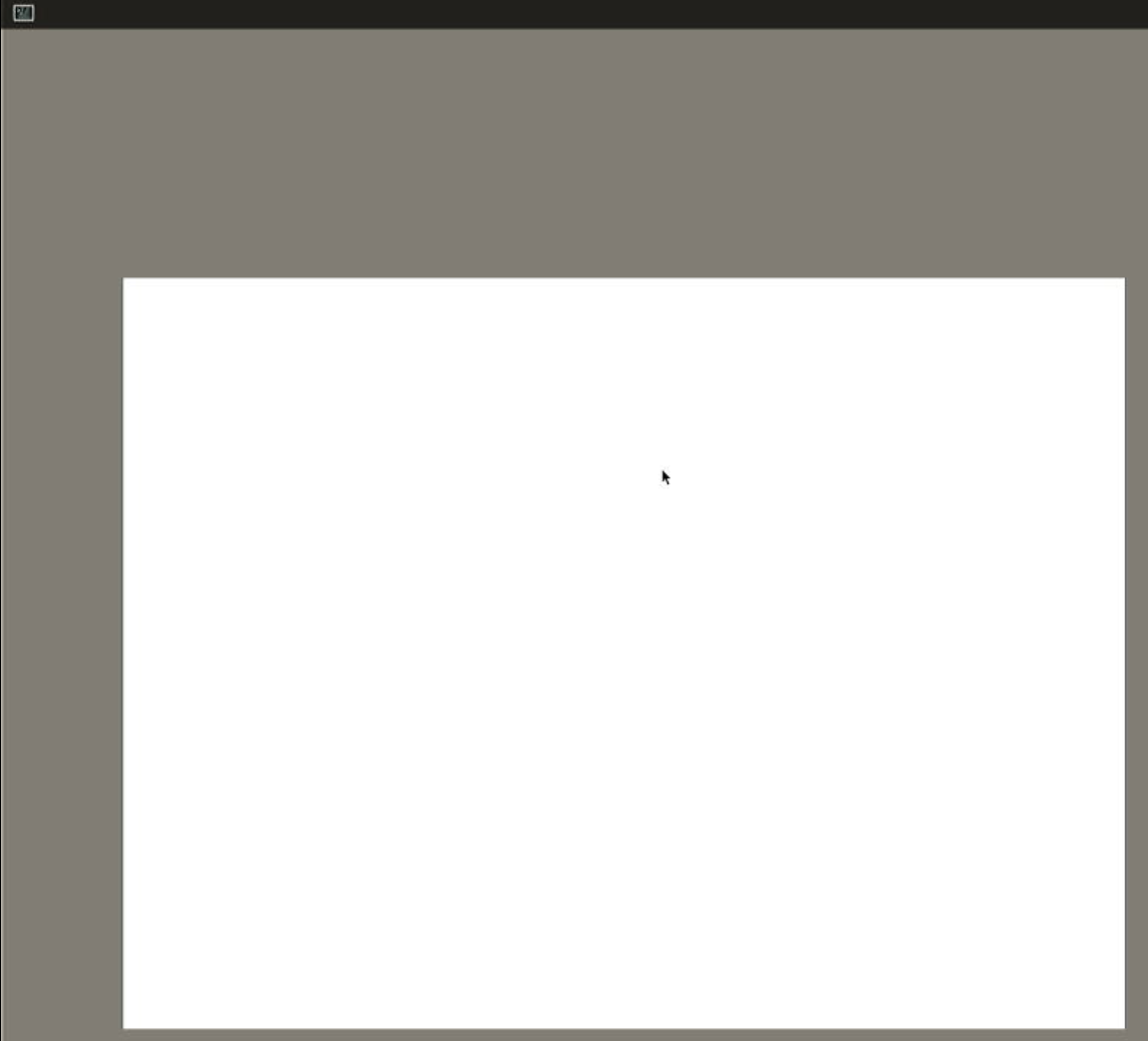

I get a blank screen (from both attempts):
As a sanity check, I loaded google.com, youtube.com (and played a video) and another simplistic local index.html
and everyone worked.
Do I need to do something special to use your videodemo?
Hi there @henrique.tx ,
This page must be hosted with some type of web-server. I personally use nginx in this case, but any other server should be fine.
Regards

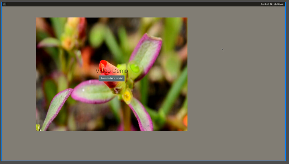

I finally could start the test.
I am recording the serial output and the HDMI video output of a Verdin iMX8M Plus. The videodemo is hosted on my notebook and the Cog browser is accessing the website via local network.
As soon as possible, I get back to you with the results.
Hi @henrique.tx ,
Thanks! fingers-crossed then
regards
Hi @anonymouse !
I let the system run for a straight 23h and I had no problem with the video. The browser is still responsible and the video is still running.
