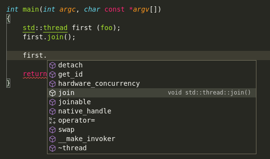

I didn’t need to modify the c_cpp_properties.json.
And the IntelliSense is working as well:
