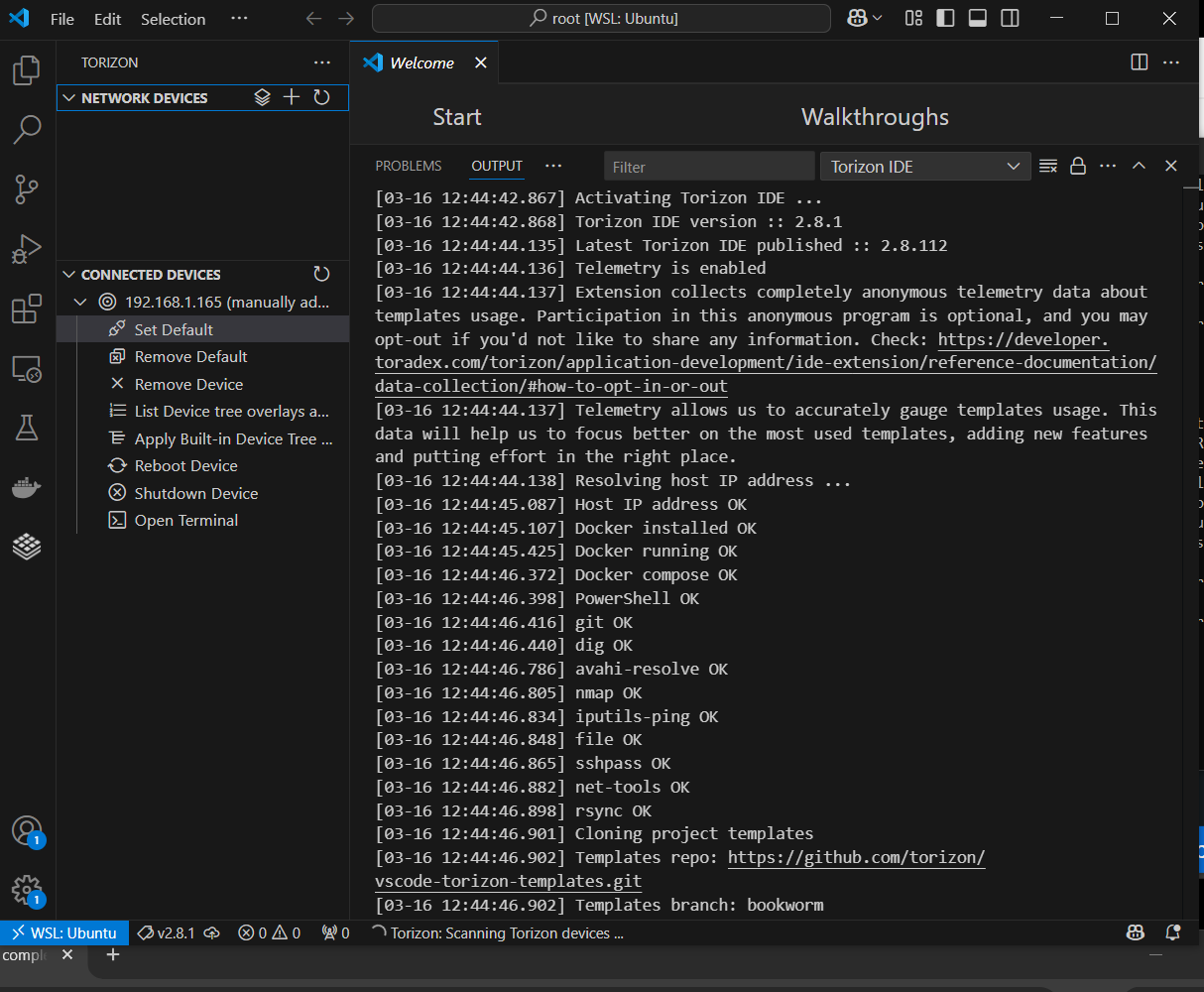

I have a iMX8 colibri connected.
Here is a snapshot of missing project creation buttons:

Hey @Jfk,
The picture/logs you have shared show the Torizon extension scanning and looking for a device. You can add a device manually, you need to scan your network to find the correct IP.

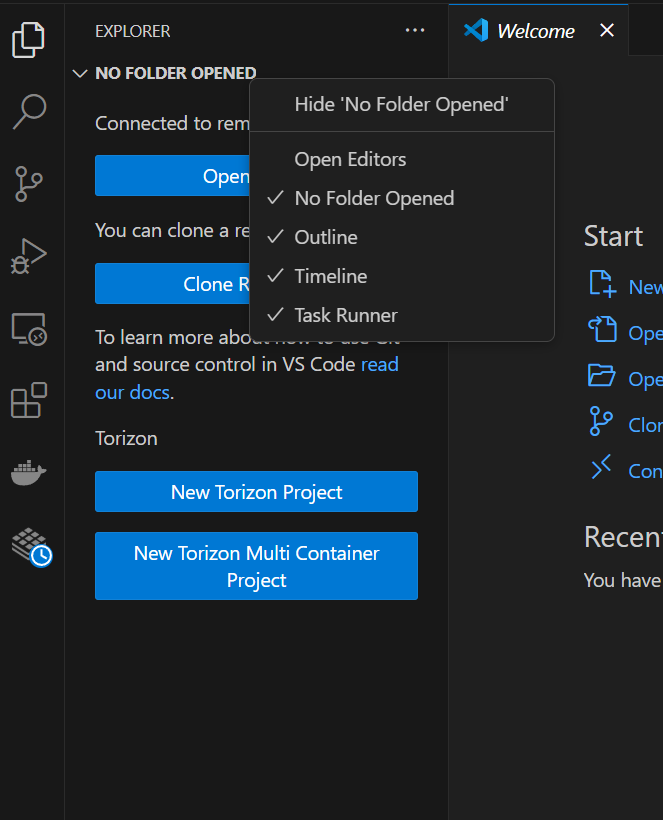

You might have the tab hidden. Can you right click in that area where the tabs are and select “No folder opened”
-Eric

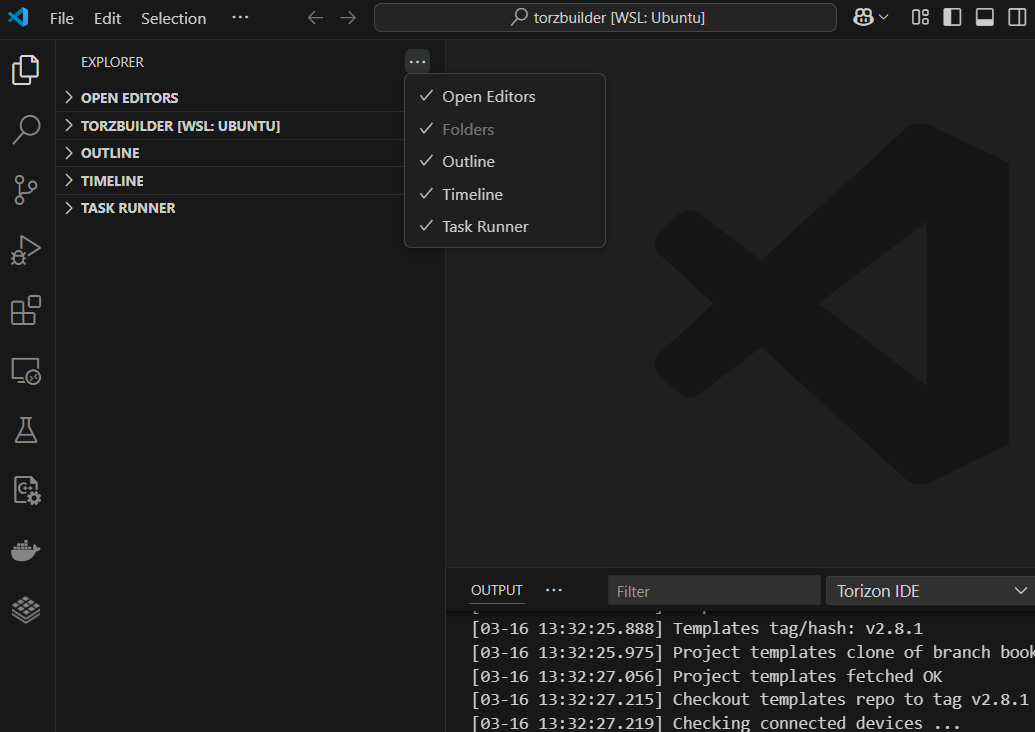

Hi Eric,
I do not have “No Folder…” option. I’ve attached my version:
It seems my Explorer is missing Toradex specific buttons, where can I look for configuration of the Explorer ?
Also, if I do a Ctrl-SH-P, Toradex does allow me to create a single container project from templates, I cannot do a New Torizon Multi Container Project.
I’m currently using my existing WSL 2 setup with all dependencies satisfied as show in the earlier log snapshot. However, I noticed during earlier install attempts the Toradex install scripts created a new Toradex WSL 2 distribution. When is creation of a new WSL distribution, entitled Toradex WSL 2 necessary?
Thanks
Hey John,
It looks like you have a project already opened. Your “TorzBuilder project” which is associated with a the non-Torizon WSL image (which still works). If you open that tab, there should be project files there.
If you go to file and close the folder, it should bring you back to the default where you can select a project new project again.
