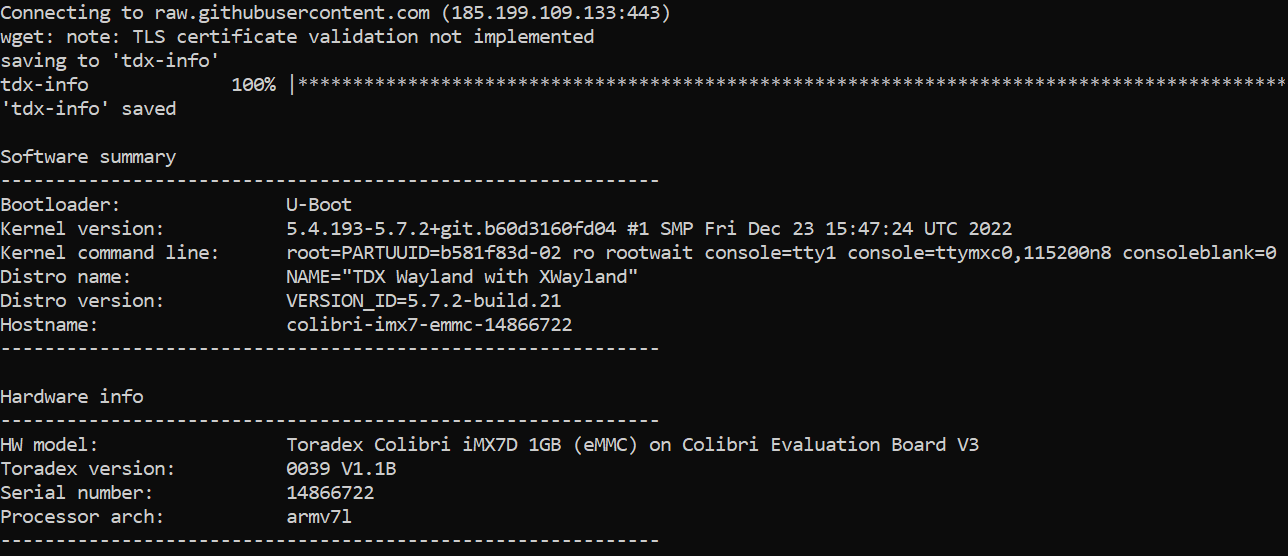

Can you please share the output of tdx-info?

This is the output of tdx-info
With VSCode extension for Torizon v1.5.1 (not the early access)

From the output of tdx-info, you are not using TorizonCore on your module. The Extension only works with TorizonCore OS.
