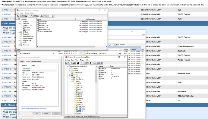

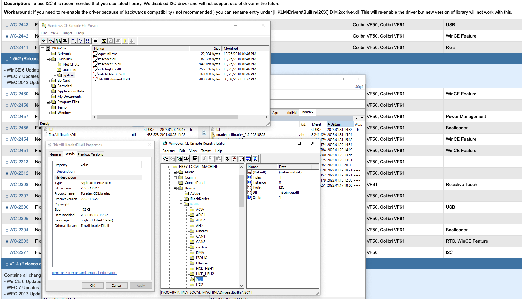

I guess there is a misunderstanding, we are not mixing versions.
We are trying to use the VF50 V1.2 B with factory settings with the latest TdxAllLibraries DLL without re-enabled I2c driver in the OS.
And with this config the I2C is not working properly, our developer pointed the difference in TdxAllLibraries DLL: VybI2c_Write and VybI2c_Read functions working differently like in the earlier version.
Because previously we used “VF50 V1.2 A” with factory settings with the latest TdxAllLibraries DLL and it handles I2C well.
So in both cases we used the VF50 modules with factory settings (no re-install) with its latest TdxAllLibraries DLL.
Can you check VybI2c_Write and VybI2c_Read functions changes please?
I am attaching a screenshot showing the dll versions.
