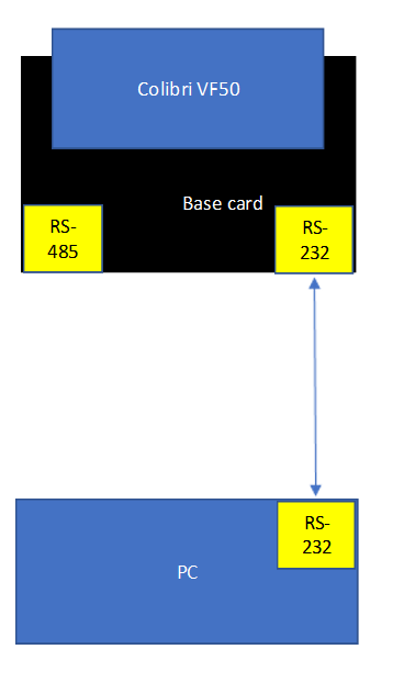

Test environment
- Colibri VF50 128MB, HW 1.2B
- OpenEmbedded core form Toradex (ready image, 2.8 | 2019-04-01)
Our test:
- The PC sends test message to the VF50 over RS-232.
- VF50 receives message and sends it back to PC.
- Software in the PC checks the time out and receives message from VF50 and compares that the received and sent messages are identical.
In this test we have identified the problem. The VF50 will not receive all characters
if a new message is sent from the PC to VF50 quickly after the previous message (less than 100ms).
In our application the VF50 should be able to receives messages even if they are transmitted
very soon after each other.
The receiving should work if the delay between the messages is 5ms (our requirement).
