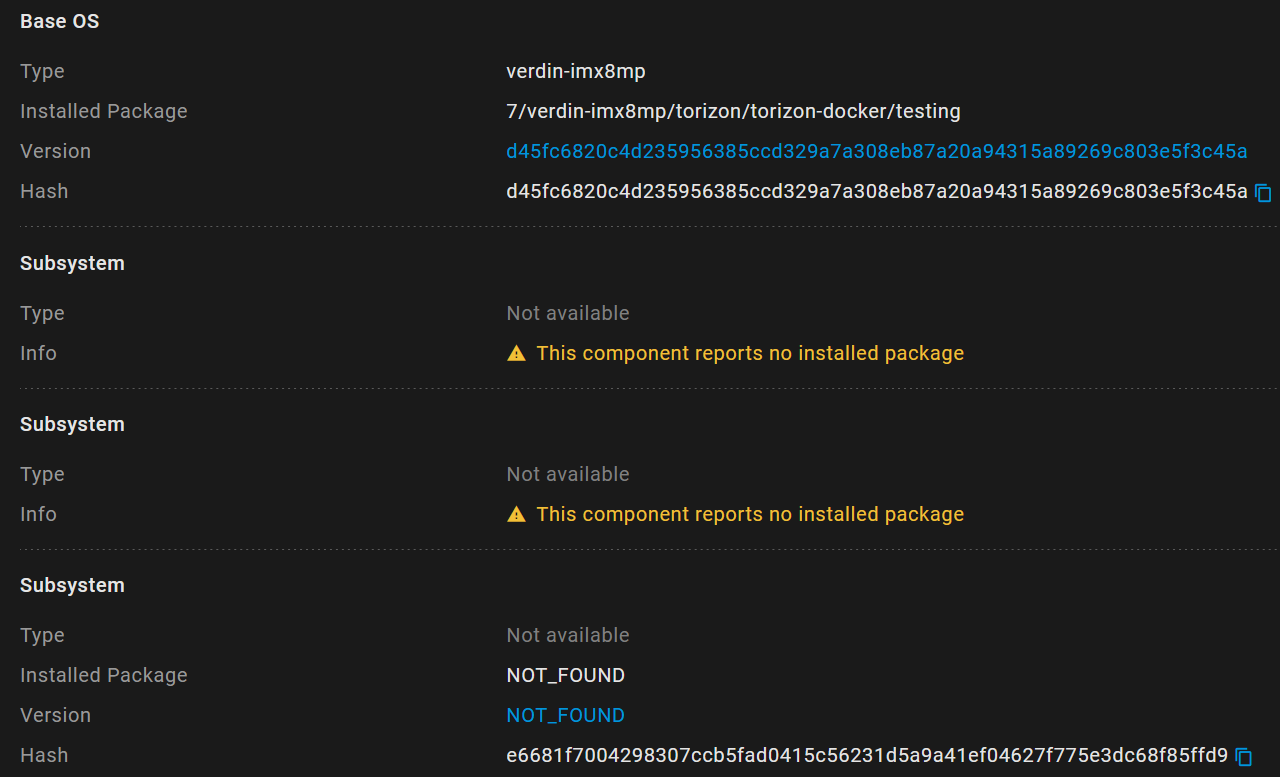

For example look at this device I have:
It has a few subsystems on it, two of these subsystems there’s no package available so there’s nothing to report. The last subsystem has a package/hash that is not even associated with any known packages in my account. But this is perfectly fine and acceptable in the sense that it does not cause any issues.
So then what behavior do you expect here exactly? Do you want your subsystems to produce some dummy version/hash if there is no existing package on the SOM yet?
You could just have the action handler for your subsystems return some dummy version/hash in such a case then. On the cloud side you would just upload some dummy file that has the same hash that the action handler will return. Then if a subsystem has this particular hash you know that it’s just a dummy hash and that this subsystem has not been updated yet.

Okay so you want to always report an accurate version/hash to Torizon Cloud for your subsystems correct? That’s the root of your issue here?
Meaning you’re not okay with the scenario I showed in my screenshot earlier where subsystems may not be able to report back any version information.

Something like this yeah. The main comparison point will be the hash. Whatever hash your subsystem action handler reports back, is the hash that Torizon Cloud will believe is “installed” on that subsystem.
Now if you happen to have a package for that subsystem in your Torizon Cloud account with the same hash, then the server will assume its the same package and match it. This will show on the web UI as saying the installed package is “xyz-whatever-name”. Now if there isn’t a matching package, then you’ll see what I showed in my screenshot earlier. The hash will still be shown but the installed package and version will just be shown as NOT_FOUND. Which denotes that something is installed on that subsystem, but the server doesn’t know what exactly is installed.
