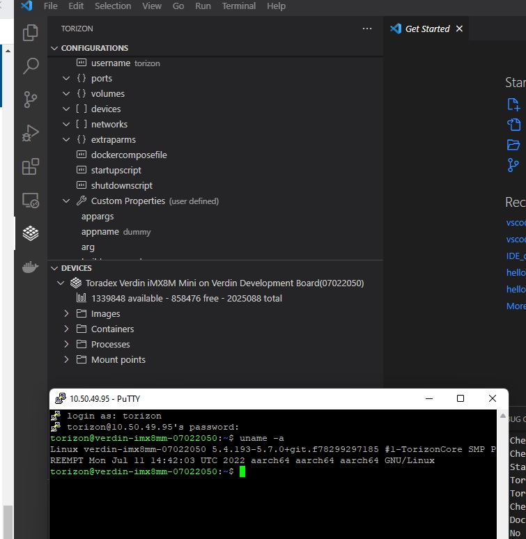

Dear @henrique.tx and @gclaudino.tx ,
As a result of the reflash through the easy installer, I can now connect the board to the VS via the network.
just one question, during the installation there were two versions 1)TorizonCore with evaluation containers(PREEMPT_RT) and second one 2) TorizonCore with evaluation containers
I chose the second one and in the image that I attached is it that without the PREEMPT_RT one?
Thank you so much for your kind support.
Mehrdad
Hi @Mehrdad!
Thanks for the update. I’m glad you’re able to connect to the board now.
Indeed. The second one is without the PREEMPT_RT Patch. We’ll report the issue with the first image internally as this patch is still experimental on TorizonCore.
Please tell us if the board starts restarting again with the image you just installed.
Can we tag this as solved? You can choose the most appropriate answer as solution :smiley:
Now, it doesn’t restart anymore. I will experiment with the SPI interface and Visual Studio and thanks for your help and for sure I will definitely do that.
