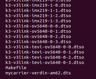

I’ve followed the steps to add a custom device tree, but the .dtb file is still not getting generated in the deploy directory.
Could you please help me figure out what might be missing?
Here’s the structure of my meta-custom-board layer:
meta-custom-board/
├── conf/layer.conf
├── recipes-kernel/
│   └── linux/
│       ├── linux-toradex-ti/
│       │   └── mycarrier-verdin-am62.dts
│       └── linux-toradex-ti_6.6.bbappend
My simple mycarrier-verdin-am62.dts looks like this:
I kept it minimal to confirm whether the .dtb gets generated:
// SPDX-License-Identifier: GPL-2.0-or-later OR MIT
/dts-v1/;
    model = "Toradex Verdin AM62 on Custom Carrier";
    compatible = "toradex,mycarrier-verdin-am62", "toradex,verdin-am62";
    chosen {
        stdout-path = "serial2:115200n8";
My .bbappend file (linux-toradex-ti_6.6.bbappend) has:
FILESEXTRAPATHS:prepend := "${THISDIR}/${PN}:"
unset KBUILD_DEFCONFIG
SRC_URI += "file://mycarrier-verdin-am62.dts"
do_configure:append() {
    cp ${WORKDIR}/mycarrier-verdin-am62.dts ${S}/arch/arm64/boot/dts/ti/
Also, I modified the Makefile here:
dtb-$(CONFIG_ARCH_K3) += k3-am62-lp-sk-microtips-mf101hie-panel.dtbo
dtb-$(CONFIG_ARCH_K3) += k3-am625-sk-mcspi-loopback.dtbo
dtb-$(CONFIG_ARCH_K3) += k3-am62-lp-sk-nand.dtbo
dtb-$(CONFIG_ARCH_K3) += mycarrier-verdin-am62.dtb  (Added this line)
after build
I don’t see mycarrier-verdin-am62.dtb inside:
tmp/deploy/images/verdin-am62/
image that dts copied to /boot/dts/ti
Best regards
uday

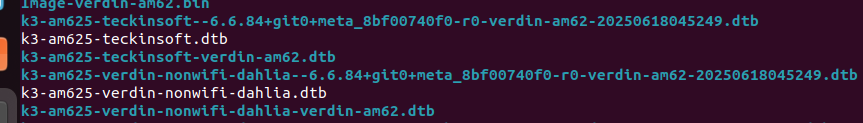

Hi @leonardo.costa.tx,
Before I start working on recipes-bsp, I have a quick question.
I can see that the k3-am625-teckinsoft.dtb file is successfully generated in the Yocto build output directory:
build/deploy/images/verdin-am62/
However, when I boot the image and check the /boot directory on the target, the k3-am625-teckinsoft.dtb file is missing.
I was expecting it to be present there so I could use fw_setenv to set it via the fdtfile variable. But since it’s not found, I’m unsure what might be going wrong or if I’m missing a step to include this DTB in the final image.
Also, to proceed with the boot setup, the .bbappend file you provided will override the fdtfile, but if the corresponding DTB isn’t even present in the image, the system won’t boot at all, right?
for reference:

Hey, @Uday10122 ,
Sorry, from your previous response I thought you had been able to deploy the device tree to the device.
Can you tell me where you put the line KERNEL_DEVICETREE:append = " ti/mycarrier-verdin-am62.dtb"? It should be in the machine file for your board in your custom layer. In my test setup, I made a file machine/verdin-am62-extra.conf:
# conf/machine/verdin-am62-extra.conf
KERNEL_DEVICETREE:append = " ti/k3-am625-verdin-wifi-leo.dtb"
After creating the machine file, you have to include it in the layer.conf file. Make sure to include it AFTER the BBPATH .= ":${LAYERDIR}" line. Here is my example:
# We have a conf and classes directory, add to BBPATH
# We have recipes-* directories, add to BBFILES
BBFILES += "${LAYERDIR}/recipes-*/*/*.bb \
            ${LAYERDIR}/recipes-*/*/*.bbappend"
BBFILE_COLLECTIONS += "meta-leo-custom"
BBFILE_PATTERN_meta-leo-custom = "^${LAYERDIR}/"
BBFILE_PRIORITY_meta-leo-custom = "25"
LAYERDEPENDS_meta-leo-custom = "core"
LAYERSERIES_COMPAT_meta-leo-custom = "scarthgap"
include conf/machine/verdin-am62-extra.conf
Before running your build, you can also run bitbake -e <your-image> | less and look for the KERNEL_DEVICETREE variable to verify that your device tree was actually appended to it (or you can run bitbake -e tdx-reference-minimal-image | grep "^KERNEL_DEVICETREE=" directly).
If the dtb file is deployed correctly, you can add the previous u-boot .bbappend and see if it works. Let me know if this solves the issue.
