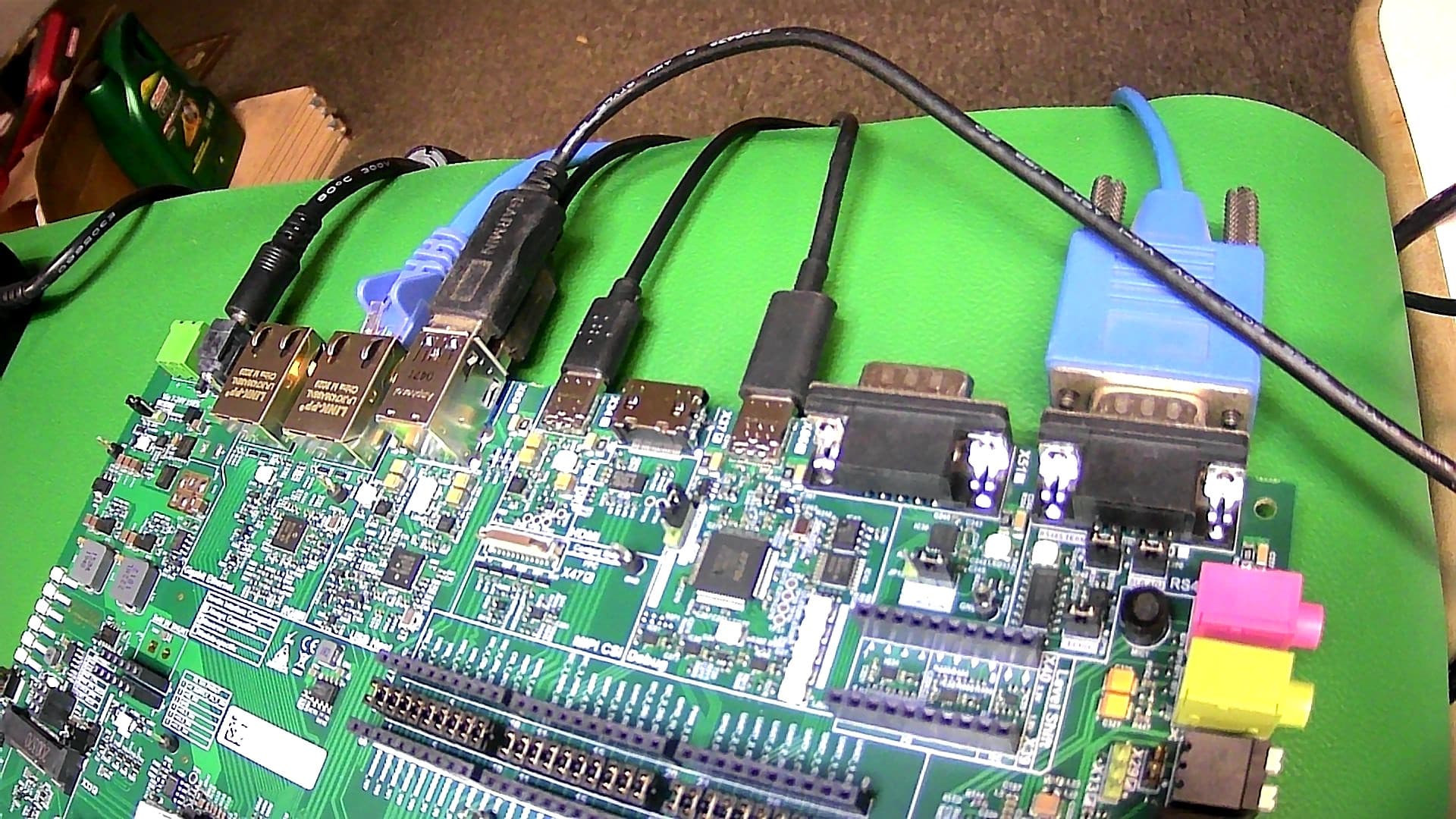

I have the two USB-C cables properly connected.
One provides COM6 and PuTTY works just fine getting over to the board. I can see two different Toradex entries in the USB devices. If map the one into the VM it disconnects COM6 as expected.

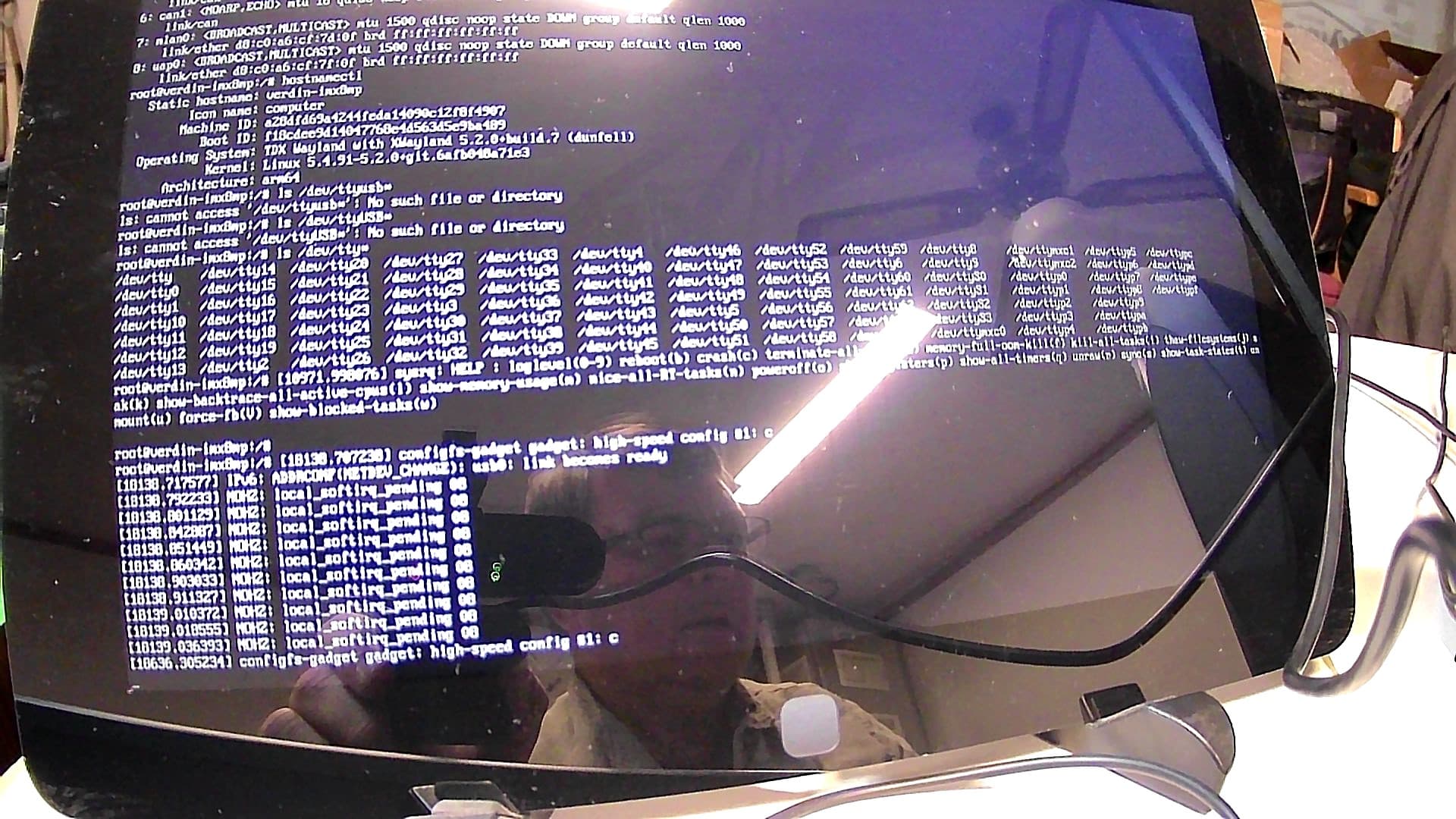

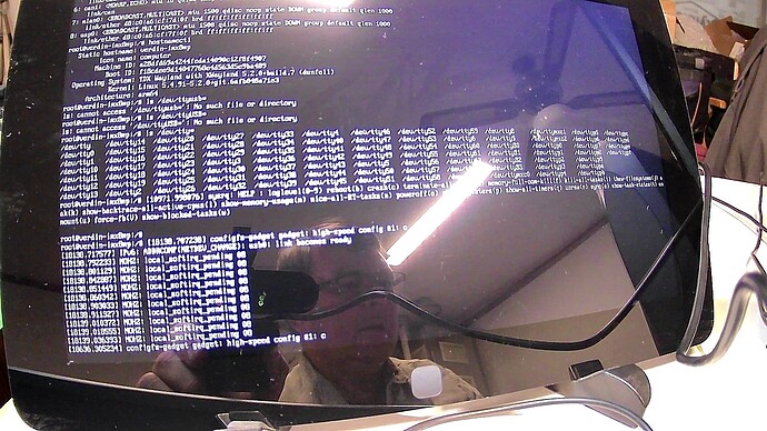

Checking the other USB Toradex into the VM tosses up the “high-speed config” message on the console.

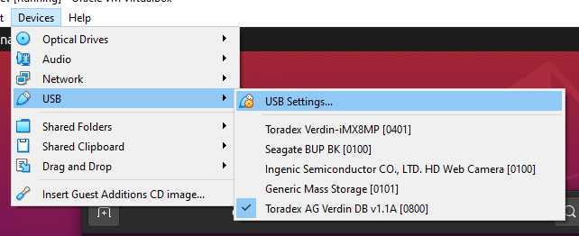

Giving the second USB device to the VM creates no device entries. uuu -lsusb finds nothing as expected.
Giving the first device to the VM not only takes away COM6, but creates the following devices.
ttyUSB0
ttyUSB1
ttyUSB2
ttyUSB3
uuu -lsusb still finds nothing.

Yes, when you connect X66 USB-C to your dev machine you will have 4 serial devices - DBG_CTL, JTAG, UART_4 and UART_3. Please check chapter 2.19 USB Debugger of Verdin Development board datasheet.
The uuu utility will see appropriate serial device only when module is in recovery mode.
We are neither support direct usage of uuu utility nor Linux virtual machine. Please use the NXP community if you have any related questions. Instead we recommend to use a native Linux box as a dev machine and the Toradex Easy Installer for an image flashing. All our module shipped pre-flashed with it.
