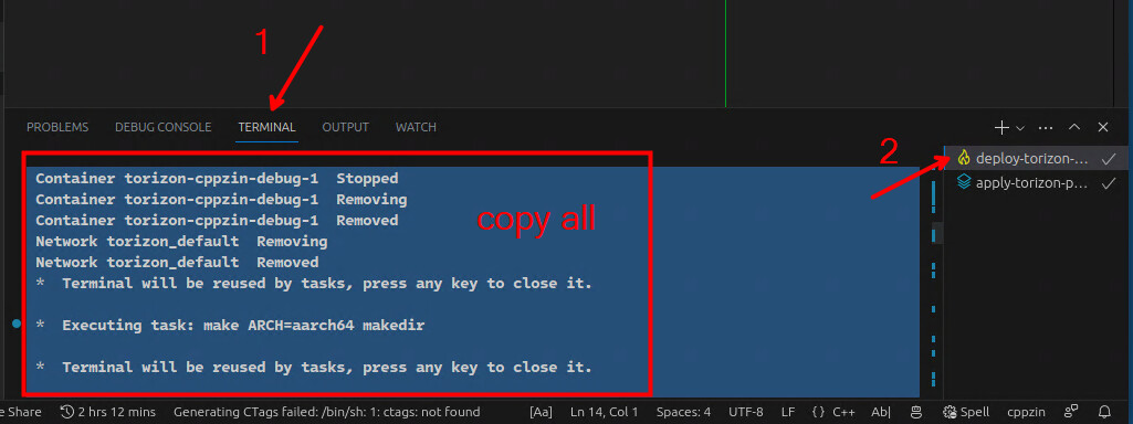

Hey @Evets
also, please send us the logs from:
This will be useful to figure out unexpected behaviors

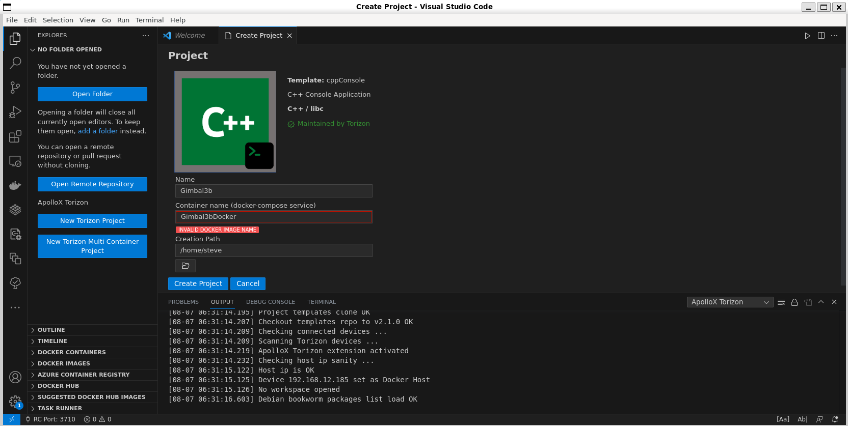

Just so you understand what I have done to start the project:
  1. launched VSCode from my wsl Ubuntu ternminal.
  2. created a new project on the Linux file system, using the C++ template.
  3. In filling out the values for the project, I was confused about what I should put for a new of the docker container. I picked one of my 4 containers that is shown in Docker, but I don’t know if it’s the right one. I have the following containers: Registry, infalliblie_wing, elegant_lichterman and brave_diffie. None of these say anything about arm64. I do have some images that do, and I have one that is based on brave_diffie that cross-toolchain-arm64-brave-diffie name.

Hey @Evets
The docker service name input is for the Docker image that will be created, not for already created or running, you can put any name that is related to your project.

Hi @matheus.tx,
Apparently, it can only be lower case letters, which seems a really weird limitation.
Here is the output and logs when trying to create a new project:
Output:
