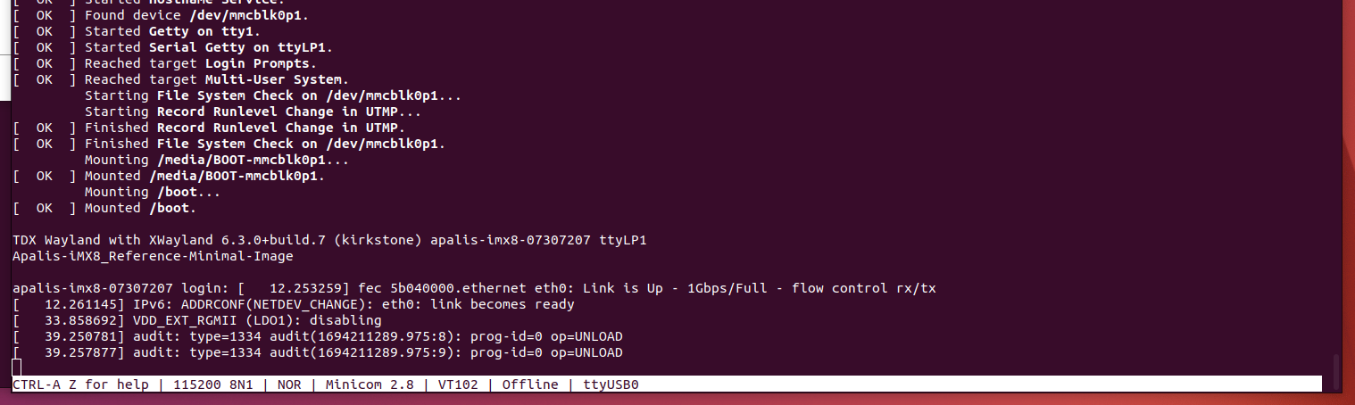

I am trying to get to the U-boot/Kernel terminal to TFTP Boot my image but I cant open the terminal to do these commands:
setenv ipaddr
setenv serverip
tftpboot ${loadaddr}
I held ENTER || SPACE while in serial debug console after reboot/reset but no success.

And if you could provide the boot log from minicom via a text format instead of a picture that would be easier to pull information from.

Good morning,
I am using Apalis iMX8- carrier board: iXora.
it’s a customized image, the image work perfectly when loaded from SD card using the Easy Installer Gui. Now I put the same image in a directory to load it from a TFTP server.
Attached is the minicom boot log .txt
I really appreciate your quick reply.
minicomLog.txt (42.2 KB)

@blouisb2,
The final message from your boot logs suggest you should be able to log in. apalis-imx8-07307207 login:
Are you not able to type root as the login nameonce you see this message? You may have to hit enter a few times to scroll down the text line.
-Eric
