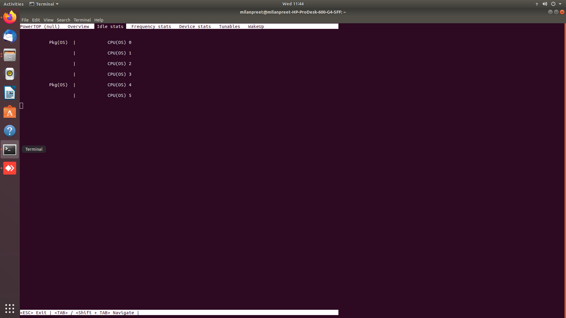

I want to use power management tool Power-top using apalis imx8 on ixora carrier board but it is not showing cores utilization as i have attached screenshot . So i just want to know whether power top tool is compatible with apalis imx8 module and if it is compatible then what are the steps to be followed.

I didn’t edit the file manually , used the kernel menu config for enabling dependencies. As i have enabled some dependency and rebuilded image as well as tested the power top on my board it doesn’t works. So please suggest me some other way as i have also send some of the dependencies are not present in kernel config or to write dependency
