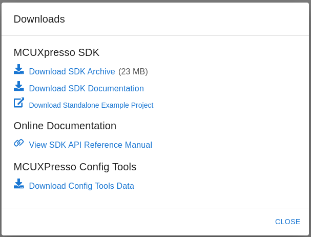

When you click to download your SDK, there is an option the download de documentation as well:
Inside the compressed file, there is a document called Getting Started with MCUXpresso SDK for MEK-MIMX8QX. Go to chapter 4 Run a demo application using IAR, there you will find instructions to compile your debug file and upload it using the JTAG Debugger.
