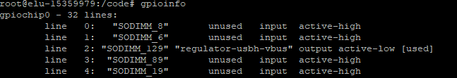

the EN Pin is attached to SODIMM 129. I want to pulldown the pin to powercycle the usb ports in software. but the io is used by “regulator-usbh-vbus" so i can not control it via gpioset.

This pin cannot be changed manually because it is bound to a regulator driver: imx6ull-colibri-eval-v3.dtsi.
In such cases, the regulator can be controlled with the sysfs interface.
Which will expose a few controls under /sys/class/regulator/regulator.X/.
X may vary, so you need to look for the regulator with the correct /sys/class/regulator/regulator.X/name value, which for this regulator is VCC_USB[1-4].
However, you should not be able to turn it off while it has consumers.
An alternative would be to disable the reg_usbh_vbus device tree node and manage this regulator manually via the GPIO pin.
