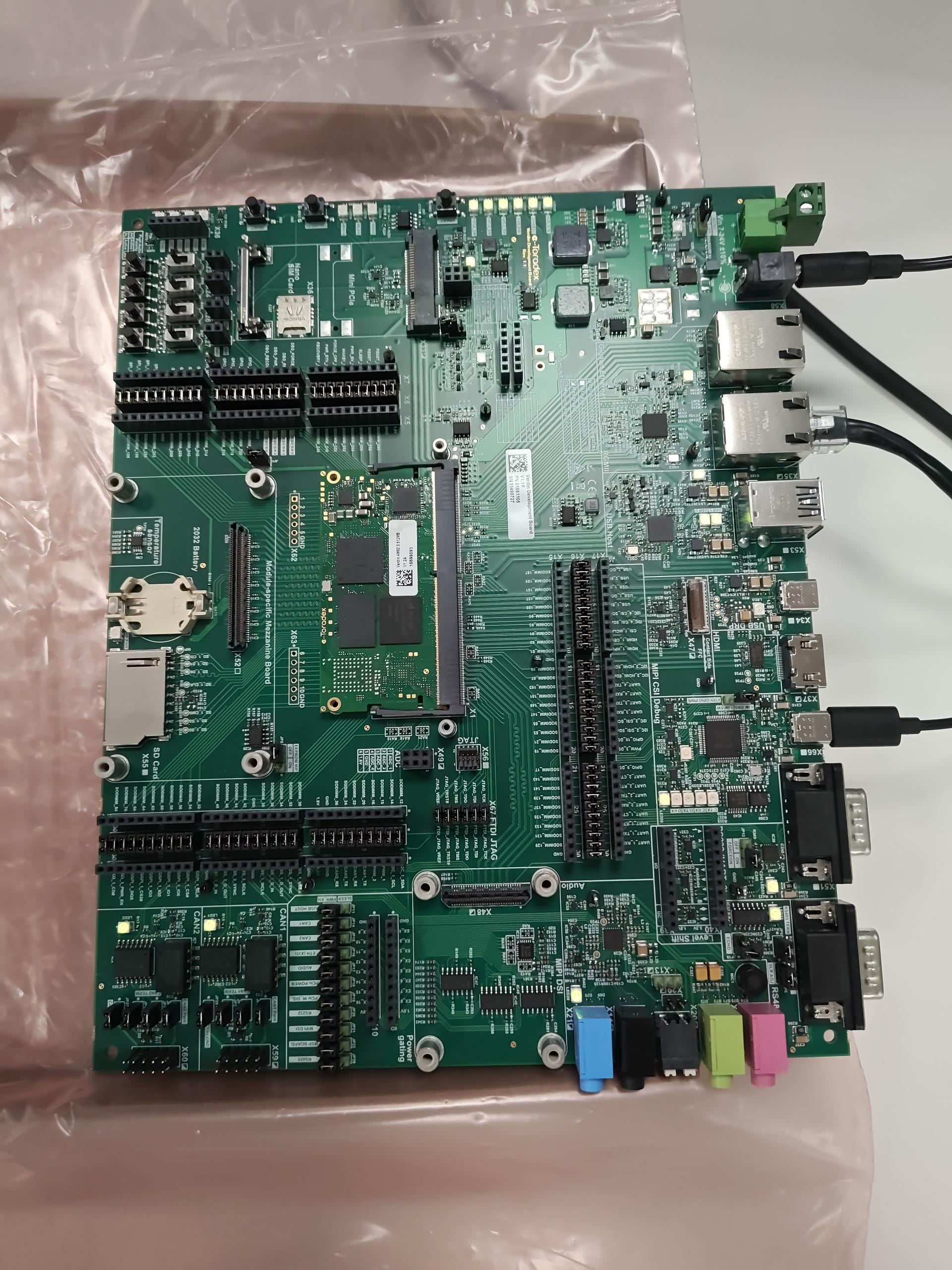

I am using Verdin dev board with Verdin AM62 512MB. when I tried to connect x66 to the laptop. I did not see any ports. this is the first time I am booting the SOM

1. Check USB Cable Quality
The USB Type-C cable you’re using may be missing data lines or be of poor quality(1). Many modern USB-C cables are charge-only. Try using a different USB-C to USB Type-A cable that you know supports data transfer(1).
2. Verify Power Supply
Ensure the Verdin Development Board is properly powered. The board should be powered on before you connect the USB cable to X66(2).
3. Identify the Correct Serial Port
The Verdin Development Board has an integrated Serial-to-USB converter that lists 4 serial ports on your computer(2).
The highest index is the Linux serial console(2). For example:
  • If you see /dev/ttyUSB0, /dev/ttyUSB1, /dev/ttyUSB2, and /dev/ttyUSB3 listed, then /dev/ttyUSB3 is the serial console(2)
  • The same logic applies to Windows COM ports(2)
4. Install FTDI Drivers (Windows)
If you’re using Windows and no ports appear in Device Manager, you may need to install the FTDI drivers(1). Check Device Manager under “Ports” or “Universal Serial Bus controllers” for any devices with yellow exclamation marks(1).
5. Connection Parameters
Once you identify the correct port, use these serial parameters(2):
  • Baud Rate: 115200
  • Parity: none
  • Bits: 8
  • Stop bits: 1
  • Flow control: none
6. Important Warning
Do not connect to the first or second port (for example /dev/ttyUSB0 or /dev/ttyUSB1)(2). If you do, you will not be able to use the board because those ports are dedicated to power/reset control and FTDI JTAG(2). Just close those connections and reset the board if this happens(2).
