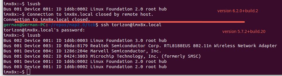

These are the images that we have tried and they do not work for us:
torizon-core-docker-colibri-imx8x-Tezi_6.2.0+build.2.tar.
torizon-core-docker-colibri-imx8x-Tezi_6.3.0-devel-202305+build.7.tar
For reference I leave a report of the lsusb command done on both images.
