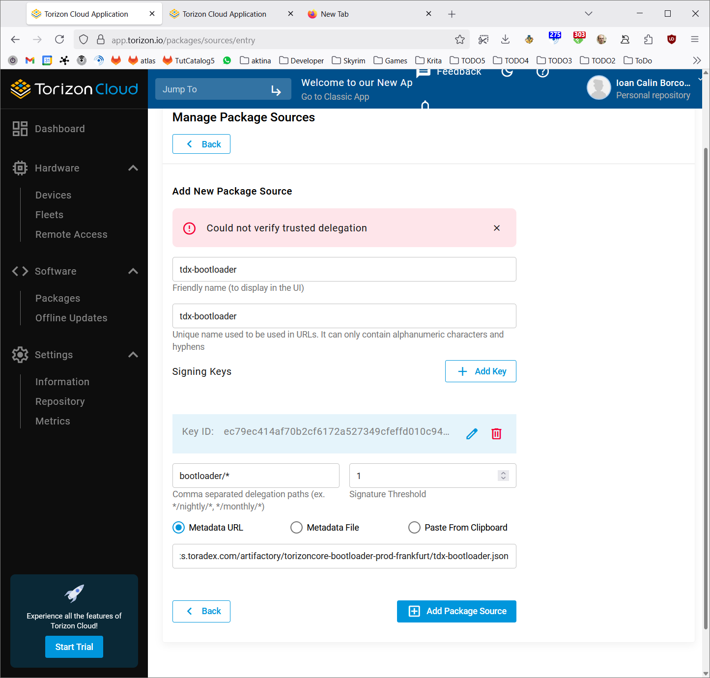

I have managed to get to a page that allows me to add a new source, but I had to manually extract a lot of the data from the https://artifacts.toradex.com/artifactory/torizoncore-bootloader-prod-frankfurt/tdx-bootloader-src.json that is supposedly the package source URL, as I found no easy way to add it directly.
The biggest problem is that, after entering all the data from the json and clicking on the Add Package Source, the web page says it couldn’t verify the trusted delegation.
So how do I add the tdx-bootloader source to my sources? Am I using the wrong documentation URL?

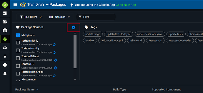

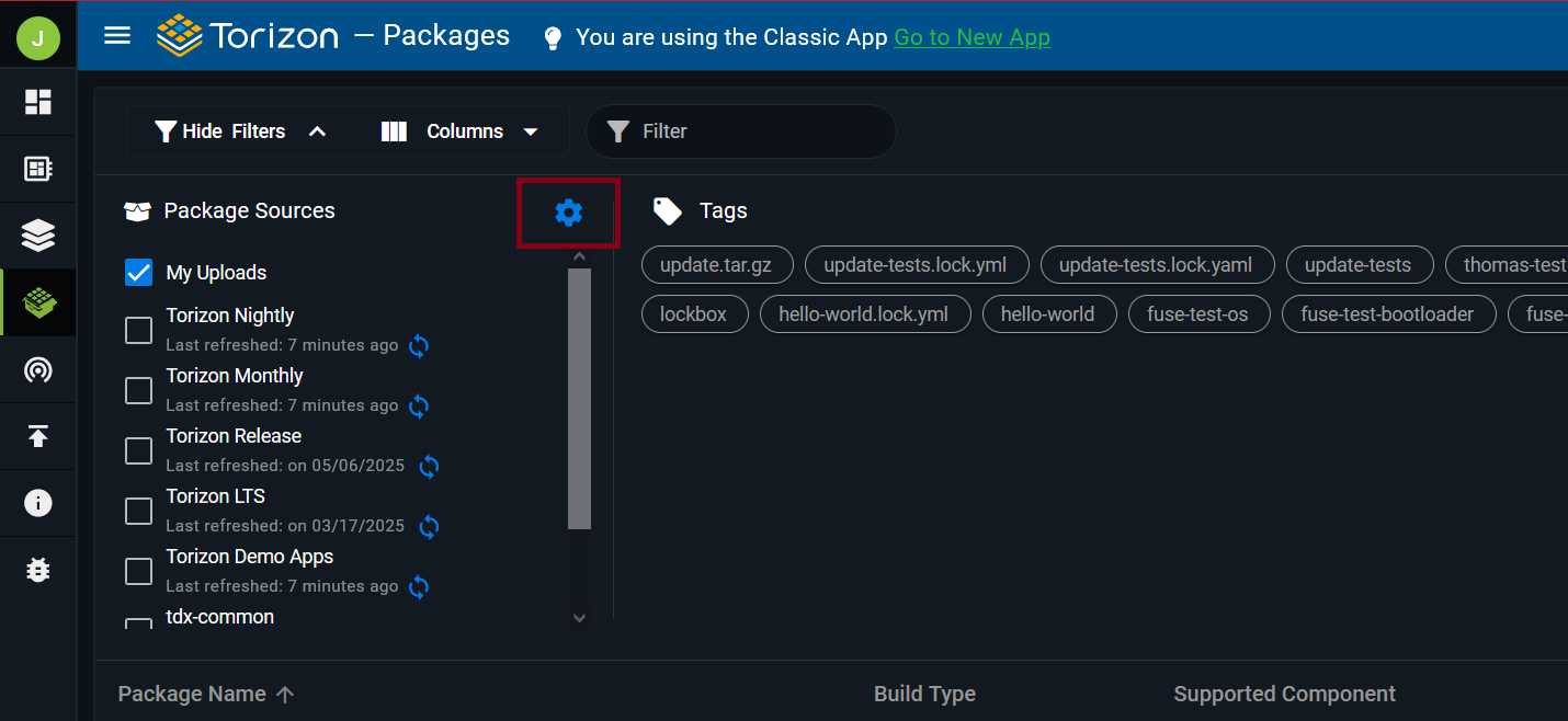

Our documentation still reflects the old web UI and hasn’t been updated yet for the current web UI. For the time-being it’s probably easier to add the bootloader package source using the old web UI. You can go back to the old web UI using the “Go to Classic App” button at the top of the current web UI.
From there you should be able to add the bootloader package source as instructed by the documentation like so:
  • Click the cog icon in the packages page.

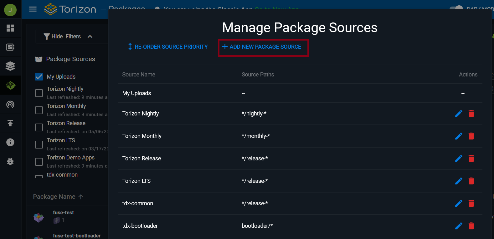

  • Then click the “ADD NEW PACKAGE SOURCE” option that shows up.
  • This should open a dialog to allow you to paste the url source (https://artifacts.toradex.com/artifactory/torizoncore-bootloader-prod-frankfurt/tdx-bootloader-src.json). The UI will then auto-extract the information.
After you add the new package source you’re free to go back to the current/newer web UI and the bootloader package source should be available there as well.
