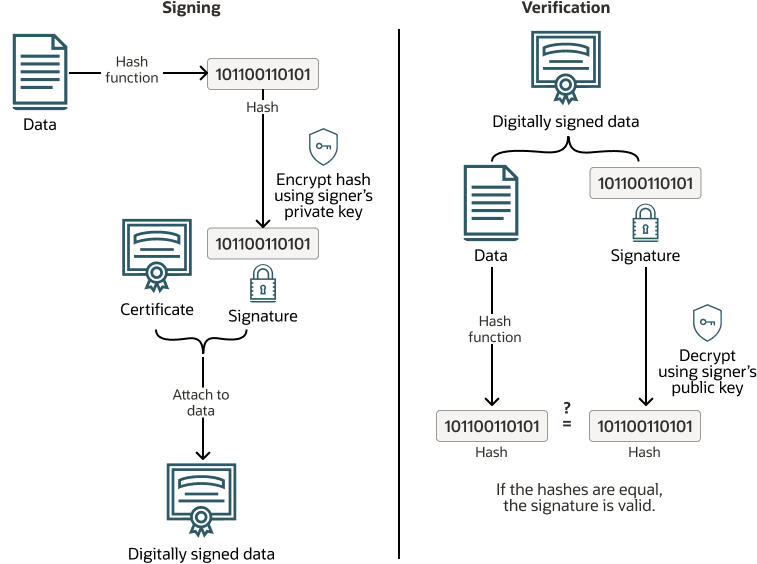

Finally, does secure boot with meta-toradex-security work like in the attached image (sboot-signverify.jpg)? Does the signing/verification follow this scheme?
