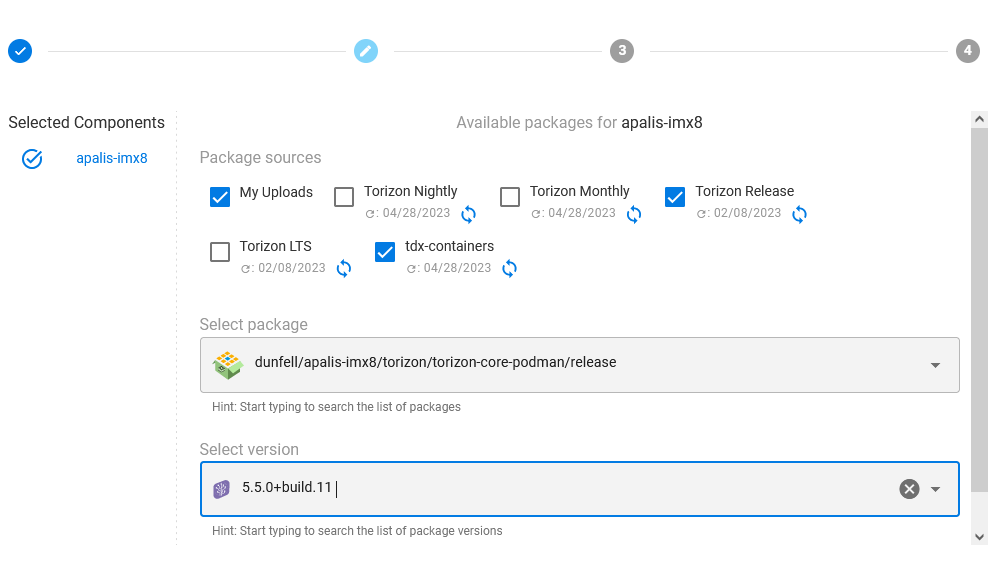

Is there a way to update Torizon OS 6 through OTA (Torizon Cloud)?
The most recent OS image proposed is 5.5.0 which looks like Torizon Core 5 :
Fabian
Fabian

Hi @fdortu ,
What Torizon OS version is currently installed on the device you want to update? If it is on Torizon OS 5 and you want to upgrade to Torizon OS 6 you first need to update to Torizon OS 5.7.2 or newer, then upgrade the bootloader, as instructed in this article:
On the image you shared you are looking at the Torizon OS Podman releases (Package name has torizon-core-podman
Most likely you’re using the Docker variant, so look in the torizon-core-docker
packages instead.

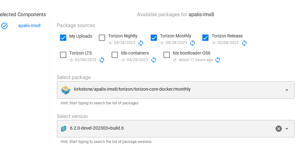

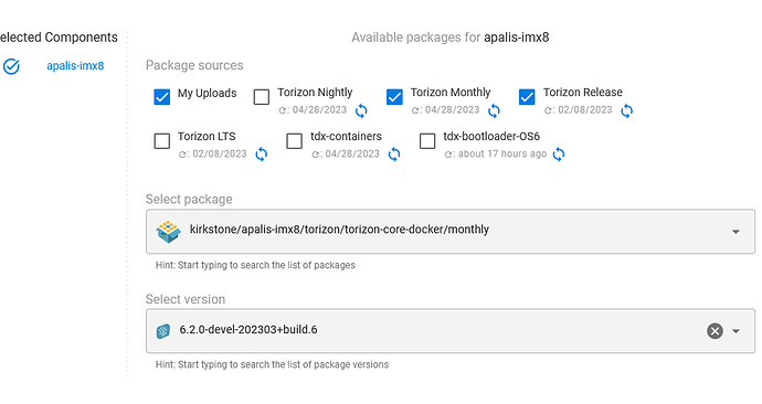

Dear Lucas,
I finally managed to apply the steps described in Bootloader Updates in Torizon OS | Toradex Developer Center
The steps one is expected to follow for upgrading TorizonCore from 5.x.y to 6.x.y are:
- Upgrade to the latest version of the OS within the same series. For example, if your device is currently running TorizonCore 5.6.0, you should first update it to 5.7.2+.
- Upgrade the bootloader to the appropriate version for the major transition.
- Upgrade the OS to the new major (6.x.y).
bootloader 2022.04-6.2.0-devel+git.0e1f11392251-n216
is installed on my target.kirkstone
images with 6.2.0-devel-202303+build.6
in Torizon monthly and upgrade to it.Best regards,
Fabian
