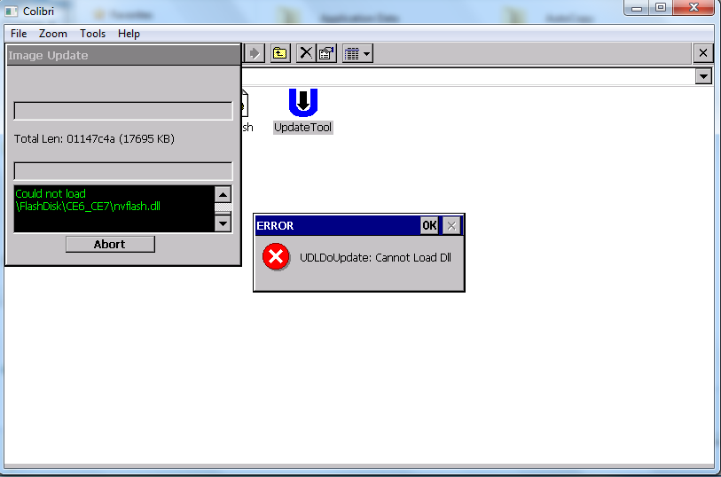

I am trying to update the OS image on Colibri T20.
I have downloaded the latest update tool and latest wince 6.0 image.
I put them in FlashDisk and ran the Update tool and browsed and selected the config file for wince6, but I get the error shown in the image that it cannot load nvflash.dll which is also in the same folder as update tool on the device.
Any suggestion how to fix this?
Thanks
Dear shiva_eghbal
The flashdisk, OS image and bootloader all share a common physical flash chip, and accessing any of these sections use the same low level flash driver.
To do a reliable update of the OS, the UpdateTool needs to lock the access to the flash. As a consequence, the DLL cannot be loaded anymore from the flashdisk.
Conclusion: You must put the UpdateTool and all related files to a different storage medium, such as a USB thumb drive or an SD card. Also the module’s root folder is fine, as it is located in RAM.
Regards, Andy
