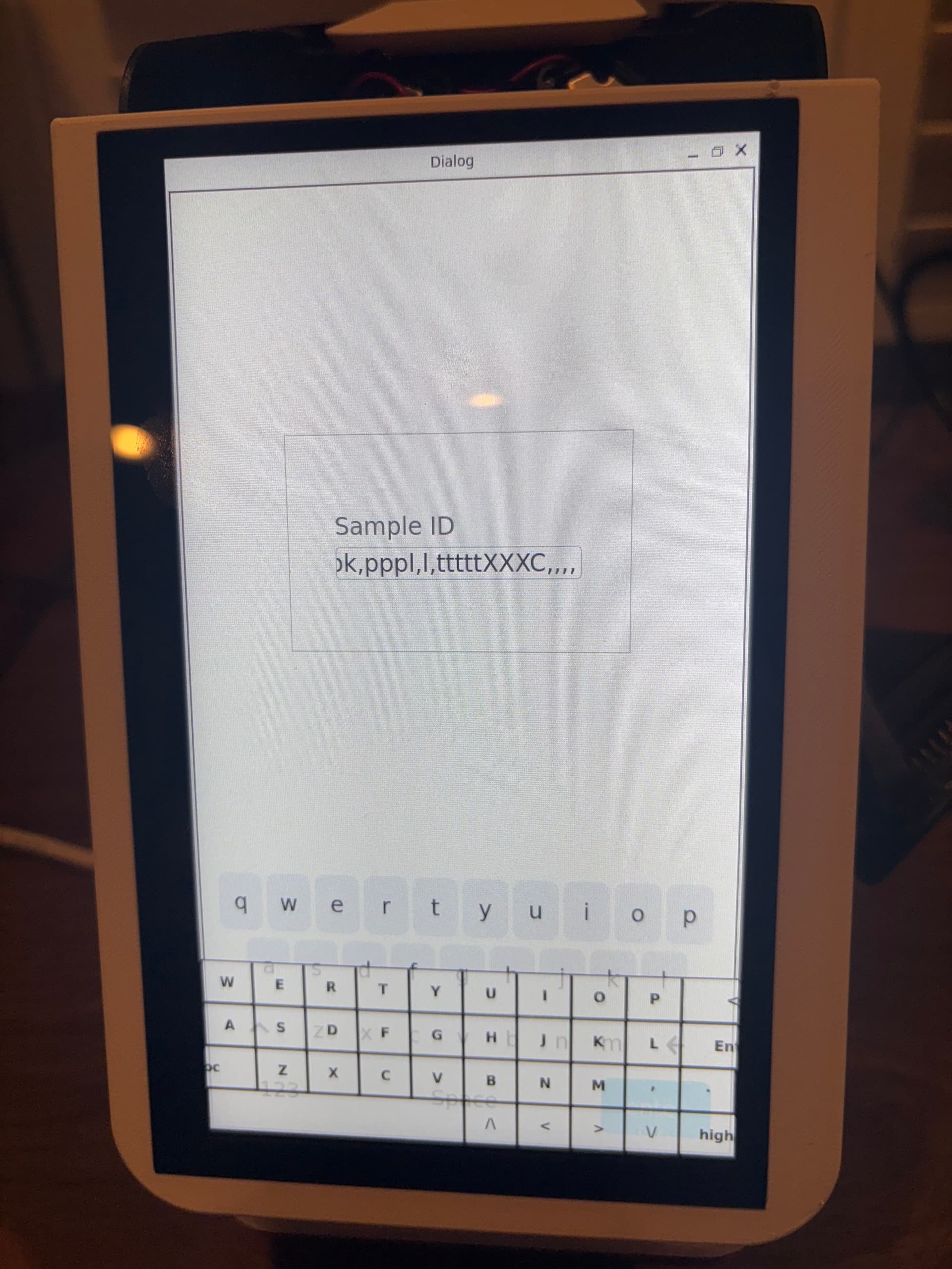

I have a Qt6 app running on the Verdin IMX8M Mini SOM on the Mallow carrier board, with the Toradex-supplied 7" capacitive touchscreen.
We are using the open-source version of Qt6 without their keyboard module, so we implemented our own keyboard. Everything looks great when running on the desktop.
When the app runs on the device, when we enter a dialog that contains our keyboard, a horrible looking virtual keyboard pops up as an overlay, and covers most of our custom keyboard. It captures the touch events so that we can’t touch our keyboard buttons that are hidden behind it. We suspect that this virtual keyboard is from Weston.
I’ve tried modifying the weston.ini file, giving a false path to the input-method path and explicitly disabling the overlay-keyboard, but that doesn’t help.

The AI suggestions don’t really help. This is what I’ve found and what I’ve tried:
  • It is definitely the Weston keyboard.
  • It’s not trivial to ensure that the Torizon Weston container is actually picking up my custom weston.ini, but I’m virtually certain that the weston.ini changes that I’ve tried are actually being used by the container.
  • Defining the suggested [input-method] section of the weston.ini file does not fix the issue.
[input-method]
path=
overlay-keyboard=false
I’ve tried removing the [input-method] section entirely, and having each of the parameters defined by itself. No luck.
  • If I manually enter the container and delete the weston-keyboard executable (/usr/lib/aarch64-linux/weston-keyboard), weston crashes on start up complaining that weston-keyboard is not available.
  • The weston process (inside the weston container) is definitely starting the weston-keyboard process. I don’t see any command line arguments to the weston executable that would disable it.
I’m a bit at the end of my rope here.

Yes, thank you! I wanted to confirm before updating this thread. Setting the path to an invalid path, rather than an empty string, worked. (No idea why). Thanks for the suggestion and for following up.
