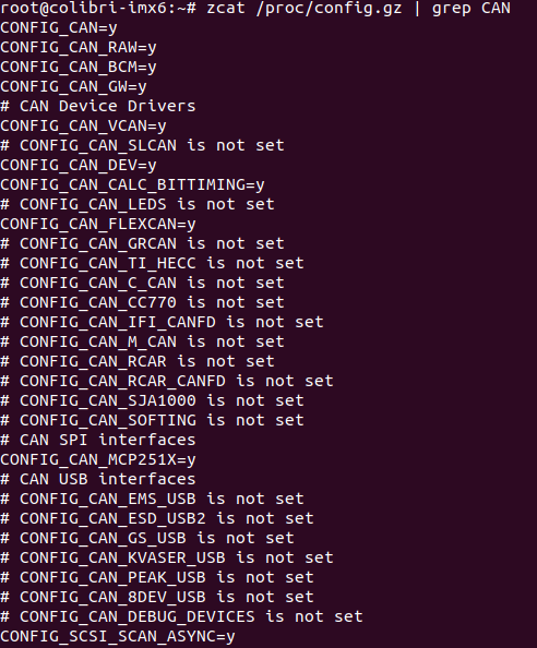

Yes, sorry I know where to find the imx6qdl-colibri.dtsi file. My question is, where do I save it after making the corresponding changes.
When I use the command dmesg | grep -i can I get the following output:
[ 0.220627] i2c i2c-1: can't use DMA, using PIO instead.
[ 0.221383] i2c i2c-2: can't use DMA, using PIO instead.
[ 1.337131] vcan: Virtual CAN interface driver
[ 1.343516] CAN device driver interface
[ 1.349590] 2090000.flexcan supply xceiver not found, using dummy regulator
[ 1.359324] flexcan 2090000.flexcan: device registered (reg_base=a09e4000, irq=35)
[ 1.370760] imx6dl-pinctrl 20e0000.iomuxc: pin MX6DL_PAD_KEY_ROW4 already requested by 20e0000.iomuxc; cannot claim for 2094000.flexcan
[ 1.386739] imx6dl-pinctrl 20e0000.iomuxc: pin-154 (2094000.flexcan) status -22
[ 1.397887] imx6dl-pinctrl 20e0000.iomuxc: could not request pin 154 (MX6DL_PAD_KEY_ROW4) from group flexcan2grp on device 20e0000.iomuxc
[ 1.414441] flexcan 2094000.flexcan: Error applying setting, reverse things back
[ 1.425989] flexcan: probe of 2094000.flexcan failed with error -22
[ 2.164710] caam-snvs 20cc000.caam-snvs: can't get snvs clock
[ 2.344434] can: controller area network core (rev 20120528 abi 9)
[ 2.359137] can: raw protocol (rev 20120528)
[ 2.365319] can: broadcast manager protocol (rev 20161123 t)
[ 2.372896] can: netlink gateway (rev 20130117) max_hops=1
I’m probably missing something, since there is no output on the flexcan. You can find the imx6dl-colibri-aster.dts here.
