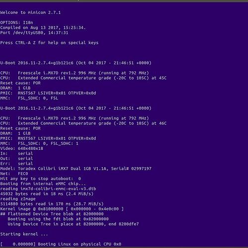

I am unable to go into UBOOT. I have previously logged in without any issues. But the countdown time for autoboot is very quick.
Kindly provide a solution.

Hi Jaski
Thanks for the reply. I tried using minicom and pressing CTRL+C but unable to go into U-BOOT.
Can you suggest any alternate solution?

Can you type in the console or not? I could not read the image you provided, could you share this again?

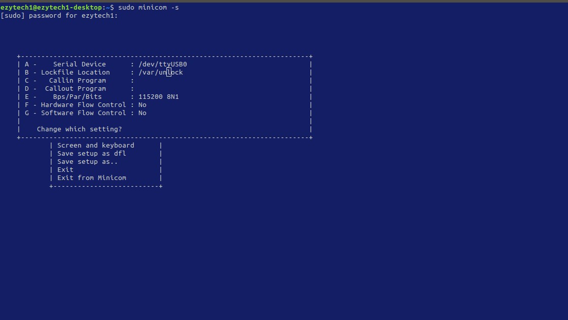

What are your port settings for minicom??

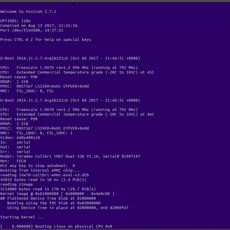

Kindly find answers for your questions
Can you type in the console or not? No i am Not able to type in console.
could you share this again? I have attached log file below
If you cannot type in the console, this might be a cable issue. Could you try a different cable? Are you using the Toradex Starter Kit?

Could you please post a complete boot log as a textual file? Should you have any of our regular demo images installed you may use fw-utils to increase the boot delay e.g. as follows:
fw_setenv bootdelay 10
I have set the boot delay command and now i am able to use UBOOT.
