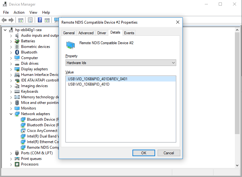

Ok a bit better, usbg loads ok, and I do see a usb0 listed as an interface, but on the other end of the usb cable, the windows host does not get indication that there is a usb ethernet interface like it used to before. Do I need to do anything else?
Hm, it seems to work here with a Windows 10 machine. The new libusgx uses Microsoft OS Descriptors which actually works with all Windows releases without installing any driver. It should just show up as a network device:
[ 15.304595] configfs-gadget gadget: high-speed config #1: c
[ 15.310524] IPv6: ADDRCONF(NETDEV_CHANGE): usb0: link becomes ready
Thanks, I rebooted it showed up. I am good to go.
