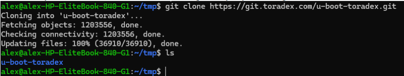

@drlangnh
I’ve successfully cloned the U-Boot repository, and everything is working as expected on my end.
Please check your network infrastructure and firewall settings — they may be blocking access.
