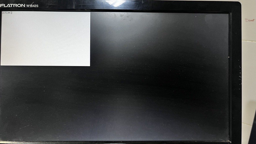

We are trying to customise & build the Linux OS image, based on the TDX-X11.
As part of the start-up behavior, we want to disable the x-term (terminal) that comes on boot-up, as would be starting our own UI app.
We are seeing the x-term before our application starts and unable to disable it by forcibly killing the process, as it keeps respawning.
Could any suggest what is the best method to complete disable the x-term/terminal on startup?
We still need the x11 to work for our application, but do not want to have the terminal shown up on the screen (please see the attached image for reference).

We have tried the below:
  1. Force killing it on boot-up, but it kept on respawning & it seems like the xterm is configured as a service with systemd & it keeps starting again.
  2. Tried removing the service from systemd, but we may not have done this correctly as this wasn’t also working.
As per you suggestion, we have also tried now by removing “xterm” from the “oe-core/layers/meta-mach/recipes-images/images/tdx-reference-minimal-image-mach.bb”. This also didn’t work.
Let me know if you require any further info.
