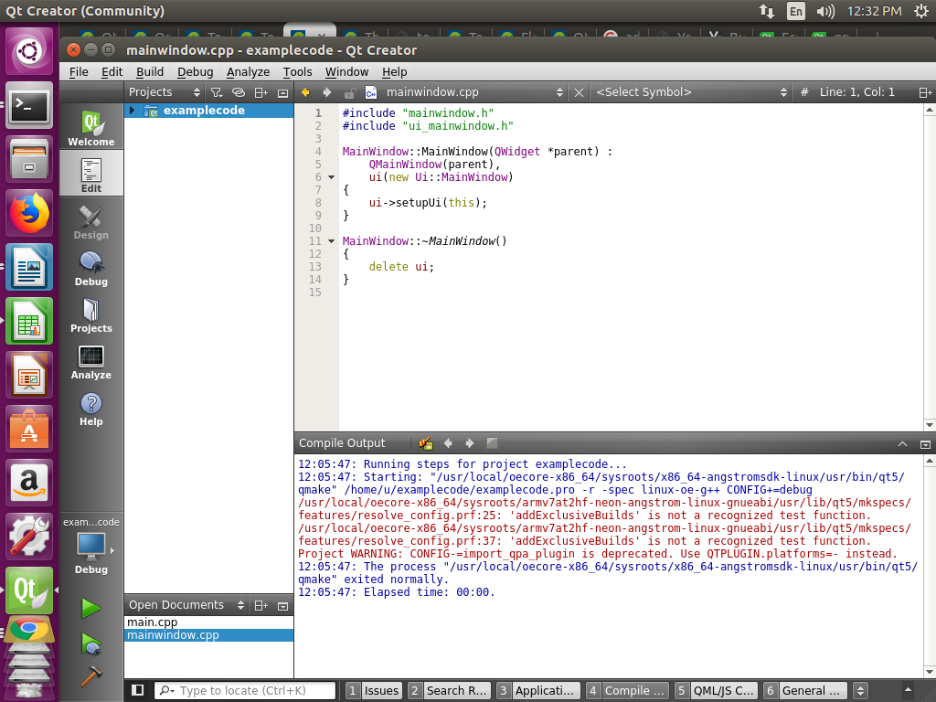

But got stuck in build and run throwing the error below:
" ‘addexclusivebuilds’ is not a recognized test function"

Now i have added IMAGE_INSTALL += “qtcharts” in the local.conf file but still getting the error ‘addexclusivebuilds’ is not a recognized test function"
And also while setting the path of QT mkspec manually,it is not supporting the Toradex Kit and showing error.You can check this in the attached screenshot.
please help me out to resolve this issue

alt text
