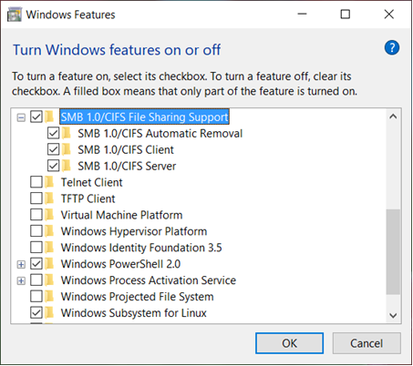

Windows 10 Laptop with SMB V1 enabled
With the IMX6 SOC I cannot access a shared folder on my laptop even with SMB V1 specifically enabled.

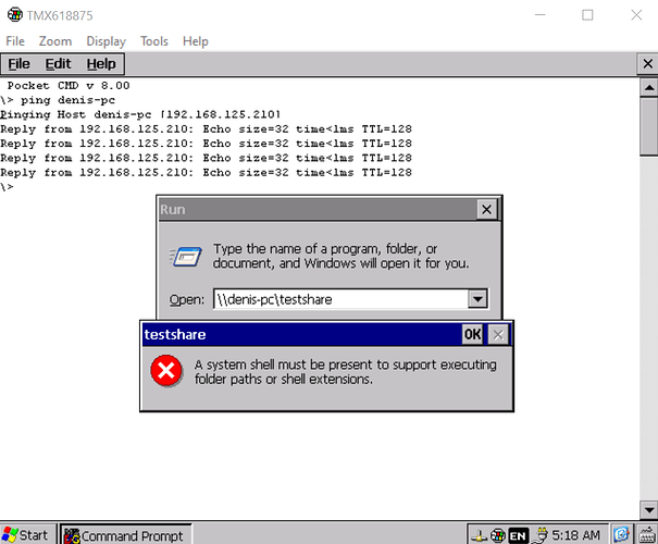

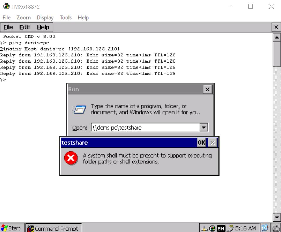

With CE8 it gets to the point where it asks for username, password and domain.
Once these are entered CE8 comes up with a dialog saying
“A system shell must be present to support executing folder paths or shell extensions”.
Not sure if the screen shot works

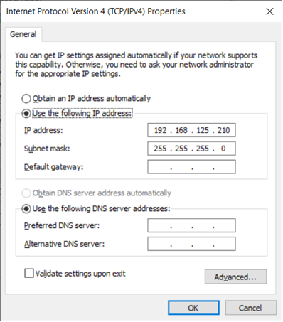

Set IP to static IP
PC:
SMB V1 enabled

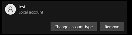

Local user added

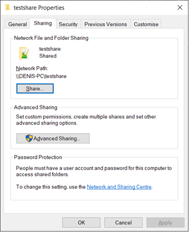

Share created
IPV4 set to static IP

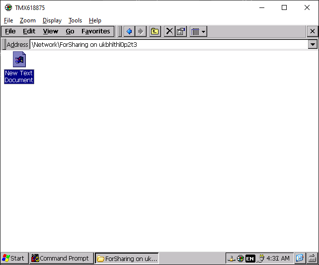

Unfortunate access to net share though explorer are not implemented on WEC2013. Please try net use command instead.
Hi
I can confirm that if I use the “net use” command I can in fact connect.
Thanks
