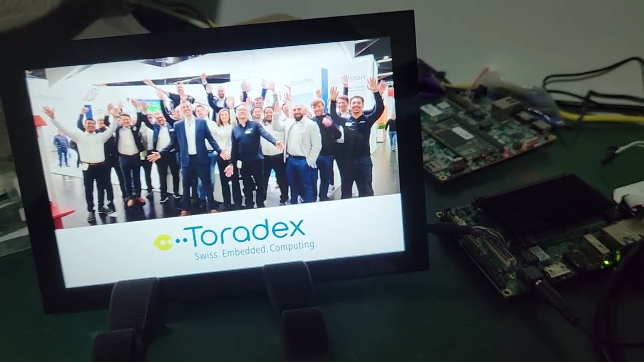

Also, I have uploaded a video of the splash screen working on U-Boot on LVDS of an Apalis iMX8QM 4GB WB IT V1.1C on an Ixora V1.2A (to prove it is true :stuck_out_tongue: ):
U-Boot Splash Screen - Apalis iMX8QM
