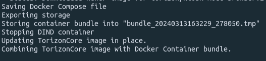

@eric.tx
torizoncore-builder --verbose --log-level debug build
2024-03-13 17:29:02,215 - torizon.tcbuilder.cli.build - INFO - Building image as per configuration file ‘tcbuild.yaml’…
2024-03-13 17:29:02,215 - torizon.tcbuilder.cli.build - DEBUG - Substitutions (enabled): {}
2024-03-13 17:29:02,277 - torizon.tcbuilder.cli.build - INFO -
=>> Handling input section
2024-03-13 17:29:03,966 - torizon.tcbuilder.backend.images - INFO - Unpacking Toradex Easy Installer image.
2024-03-13 17:29:03,967 - torizon.tcbuilder.backend.images - DEBUG - Running tar command: cat /workdir/torizon-core-docker-verdin-imx8mp-Tezi_6.6.0-devel-20240305+build.522.tar | cat | tar -xf - -C /storage/tezi.tmp
2024-03-13 17:29:04,528 - torizon.tcbuilder.backend.images - INFO - Copying Toradex Easy Installer image.
2024-03-13 17:29:04,528 - torizon.tcbuilder.backend.images - DEBUG - Copy directory /storage/tezi.tmp/torizon-core-docker-verdin-imx8mp-Tezi_6.6.0-devel-20240305+build.522 → /storage/tezi.
2024-03-13 17:29:04,703 - torizon.tcbuilder.backend.images - INFO - Unpacking TorizonCore Toradex Easy Installer image.
2024-03-13 17:29:04,704 - torizon.tcbuilder.backend.images - DEBUG - Running tar command: cat ‘/storage/tezi/torizon-core-docker-verdin-imx8mp.ota.tar.zst’ | zstd -dc | tar --xattrs --xattrs-include=‘*’ -xhf - -C /storage/sysroot
2024-03-13 17:29:08,488 - torizon.tcbuilder.backend.images - INFO - Importing OSTree revision b335e79d27949c07af0a4c5c31500fc66e153dd8b597debd7dcfe19389583374 from local repository…
2024-03-13 17:29:08,490 - torizon.tcbuilder.backend.ostree - DEBUG - Pulling from local repository /storage/sysroot/ostree/repo commit checksum b335e79d27949c07af0a4c5c31500fc66e153dd8b597debd7dcfe19389583374
921 metadata, 9128 content objects imported; 582.9 MB content written
2024-03-13 17:29:12,705 - torizon.tcbuilder.backend.ostree - DEBUG - Pulling from local repository /storage/sysroot/ostree/repo commit checksum b335e79d27949c07af0a4c5c31500fc66e153dd8b597debd7dcfe19389583374
0 metadata, 0 content objects imported; 0 bytes content written
2024-03-13 17:29:12,762 - torizon.tcbuilder.backend.images - INFO - Unpacked OSTree from Toradex Easy Installer image:
2024-03-13 17:29:12,762 - torizon.tcbuilder.backend.images - INFO - Commit checksum: b335e79d27949c07af0a4c5c31500fc66e153dd8b597debd7dcfe19389583374
2024-03-13 17:29:12,762 - torizon.tcbuilder.backend.images - INFO - TorizonCore Version: 6.6.0-devel-20240305+build.522
2024-03-13 17:29:12,762 - torizon.tcbuilder.cli.build - INFO -
=>> Handling customization section
=> Handling device-tree subsection
2024-03-13 17:29:12,762 - torizon.tcbuilder.cli.dto - DEBUG - Removing all overlays
2024-03-13 17:29:12,811 - torizon.tcbuilder.cli.build - INFO - Not testing overlay because base image does not have a device-tree set!
=> Adding device-tree overlay ‘device-trees/overlays/verdin-imx8mp-gimbal3b-overlay.dts’
2024-03-13 17:29:12,836 - torizon.tcbuilder.backend.dt - INFO - ‘verdin-imx8mp-gimbal3b-overlay.dts’ compiles successfully.
2024-03-13 17:29:12,860 - torizon.tcbuilder.cli.dto - INFO - Overlay verdin-imx8mp-gimbal3b-overlay.dtbo successfully applied.
2024-03-13 17:29:12,860 - torizon.tcbuilder.cli.build - INFO -
=>> Handling output section
2024-03-13 17:29:12,860 - torizon.tcbuilder.cli.union - DEBUG - union: subject=‘None’ body=‘None’
2024-03-13 17:29:12,862 - torizon.tcbuilder.cli.union - INFO - Applying changes from STORAGE/dt.
2024-03-13 17:29:12,864 - torizon.tcbuilder.backend.union - DEBUG - Processing whiteouts.
2024-03-13 17:29:12,970 - torizon.tcbuilder.backend.union - DEBUG - Transaction committed. 2946 bytes 2 objects written.
2024-03-13 17:29:12,974 - torizon.tcbuilder.cli.union - INFO - Commit 43f5511447c81e6fc9a8e555b3dbc60aa0d66438c3ab5aac6ebb49651631f2e7 has been generated for changes and is ready to be deployed.
Deploying commit ref: tcbuilder-20240313172912
2024-03-13 17:29:12,980 - torizon.tcbuilder.backend.deploy - INFO - Pulling OSTree with ref tcbuilder-20240313172912 from local archive repository…
2024-03-13 17:29:12,980 - torizon.tcbuilder.backend.deploy - INFO - Commit checksum: 43f5511447c81e6fc9a8e555b3dbc60aa0d66438c3ab5aac6ebb49651631f2e7
2024-03-13 17:29:12,980 - torizon.tcbuilder.backend.deploy - INFO - TorizonCore Version: 6.6.0-devel-20240305+build.522-tcbuilder.20240313172912
2024-03-13 17:29:12,980 - torizon.tcbuilder.backend.deploy - INFO - Default kernel arguments: quiet logo.nologo vt.global_cursor_default=0 plymouth.ignore-serial-consoles splash fbcon=map:3

The weird thing is i can do these things from commandline:
docker save -o myimage.docker localhost:5002/gimbal3b container-debug:arm64 with no issue.
And also:
docker pull localhost:5002/gimbal3bcontainer-debug:arm64
arm64: Pulling from gimbal3bcontainer-debug
Digest: sha256:3d792e9ebea12ff6d6c362b598a164bac1feebf18e9fddbdd1605ce275e25447
Status: Image is up to date for localhost:5002/gimbal3bcontainer-debug:arm64
And that works fine. Why is it that the pull from within torizoncore-builder doesn’t work?
I do see this under docker info:
WARNING: daemon is not using the default seccomp profile
And thus:
docker info --format ‘{{ .SecurityOptions }}’
[name=seccomp,profile=unconfined]
is that normal?
Steve
Hey @Evets,
From your logs, It looks like you have your containers stored at an unsecured registry. HTTP vs HTTPS. Torizoncore-builder uses Docker-in-Docker container instances to obtain the images, so you will need to pass extra parameters depending to allow/inform DIND of the insecure registries.
Please see this article.
-Eric
@eric.tx
Yes, I had already read this and tried it, got the same answer, i.e. connection refused. I used port 5002 since that is the only port it’s listening on. I just tried it again and got the same results.
And in the logs from builder I see an insecure fetch without setting that parameter (which cab only be used in the bundle command), i.e., from the logs with bundle and that parameter set,
(“Get http://localhost:5002/v2/: dial tcp 127.0.0.1:5002: connect: connection refused”)
And also in the logs with the build command. It is showing an http connection not an https connection.
Steve
@eric.tx
I can fetch and save the image somewhere. Can I use that somehow to build everything?
Steve
@Evets,
Can I ask how are you hosting your images. Is it via: https://hub.docker.com/_/registry locally on your machine? Can you describe what is running on windows for you and what is running on wsl, in regards to docker?
Also, when you attempted the parameters for insecure registries, did you change how your tcbuild.yaml file reflects the different bundle methods?
-Eric
The images are hosted on my machine’s repository, built by VSCode. I tried creating an image on the board, via the commit command and that works too. But I can’t seem to pull it from the board, OR use the image made by VSC since I can’t get it to pull it. The image is shown with docker images in wsl, but it is not in the list on the windows side.
I have just installed docker. Nothing special, but it has been updated several times. I have a docker hub login, which I’ve had for a long time for myself. But I can’t tell you whether it is a secure registry or not, but by the info, it looks as if it is, and the fact that it refuses the connection for a normal http: connection, tells me that a non-secure connection is being attempted.
I just ran the command as recommended by the example, with the added parameter. It doesn’t use the tcbuild.yaml for that, i.e.
torizoncore-builder bundle --dind-param=“–insecure-registry=localhost.:5002” docker-compose.yml
@eric.tx
I can do this with no issue on my PC in wsl:
docker pull localhost:5002/torizon6gimbal3b:latest
This works fine. What command is builder actually doing trying to pull the image? It says in the logs:
“File “/builder/tcbuilder/backend/bundle.py”, line 573, in download_containers_by_compose_file”
is that just trying to save the image? Or is it doing something to it? Because a pull just brings to the local registry.
In my docker info it has this:
Insecure Registries:
hubproxy.docker.internal:5555
127.0.0.0/8
which means if you pull from localhost, it should default to insecure Registries. However, you are doing something separate because it should connect, not refuse, or timeout. It doesn’t go long enough to timeout.
Steve
