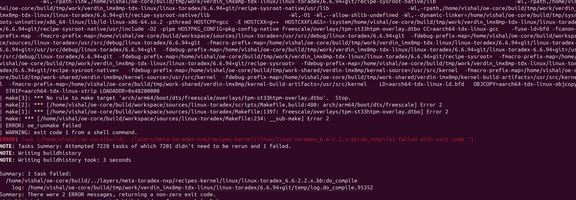

5. Verify TPM driver
ls -l /dev/tpm*
dmesg | grep -i tpm
When i did 5th steps in above “No such file or directory“ message will appear.
Please help me to address problem where I am doing wrong?
