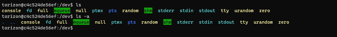

It seems like /dev is not getting populated fully inside of the container when I bind mount it:

Though based on your screenshot it would appear that your assessment is correct and that the bind-mount to dev isn’t working for some reason.
