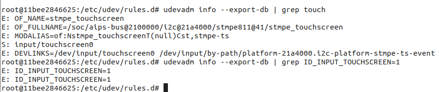

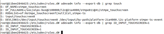

We are using 5.3 inch touch screen and I have tried it with torizon/arm32v7-debian-weston-touch-calibrator container to check the touch screen functionality and I am able to do the touch calibration without any issue. But same touch screen is not working with Debian Qt5 Container.
Debian container detects touchscreen.
